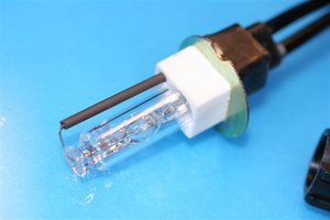

I did happen to find some at a place called Retro Solutions (http://www.retrosolutionsllc.com/servlet/the-183/DIGITAL-HID-XENON-BULBS/Detail). Their 55w H3 HID bulbs actually have the thin metal base plate and the wire inputs look offset...possibly these might fit the Hella 700FF's just like stock halogen bulbs and use the factory clip to hold them in (see pic below). $51.99 for a pair of bulbs and they give a lifetime warranty on them.

I know the DDM Tuning lights, ballasts, etc are from China. The Retro Solutions site shows a pic of the inside of a ballast and it says "Made in Germany".
I am going to order some of their bulbs and use them with my DDM Tuning Raptor ballasts.
