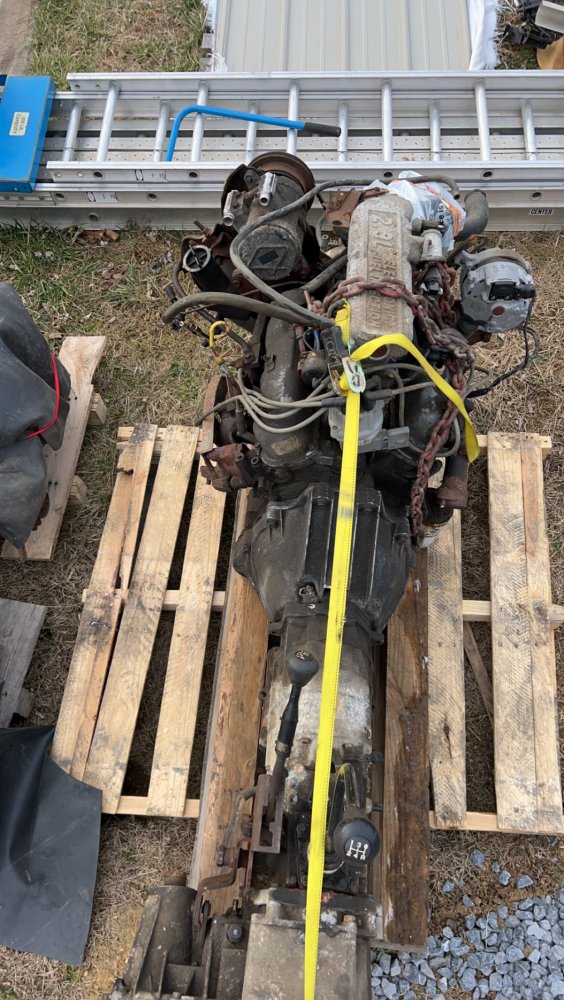

Well I went ahead and got a 2.9 bolted up to a FM145 bolted to a BW1350 transfer case. I’ve got the clutch pedal assembly coming. So I think that means most of the stuff you mentioned I shouldn’t have to worry about, because it ran great and shifted good before it was pulled.
