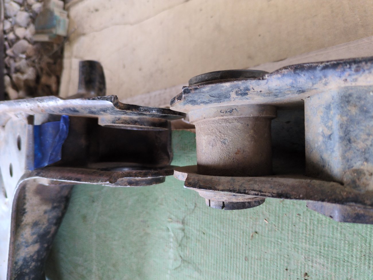

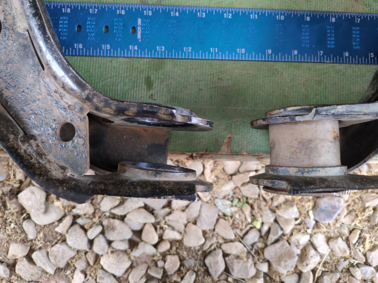

I'm working on my new to me 1999 Ranger (see my post in https://www.therangerstation.com/fo...ts-upper-control-arm-stuck-to-knuckle.216321/ ) and I ended up deciding to reuse my old control arms and put new bushings and high quality ball joints (TTX)'es in them. I had a very hard time removing the bushings and I think my control arms are a little bend, which might actually contribute to me having such a hard time getting them out. So far my only luck has been drilling out the rubber and then cutting through the metal sleeve. I still have more to remove in the picture.
When I got the second control arm out I noticed that one flange (extrusion with the hole) is definitely 'off' and there is a chance that they're all bend a little. My idea is to try and straighten it out and I'm wondering if there's a good way to know where to align it to. Are the flanges supposed to be perfectly parallel ? How accurate do I need to be or is this a matter of 'tough luck, get new arms' ?
I'm open to any suggestions or ideas on how to go about this. Maybe someone has accurate measurements I can use.
Thanks

You will know it's off too much if you can't get the shafts in place. The arms getting bent is common, people running over things and denting them is common. I would just eyeball it the best you can, especially if they got a little bent taking them out. I have seen fixtures they use to support the thin arm when they use a press.
After you get it together, the alignment shop should be able to compensate for anything that is a little off.
