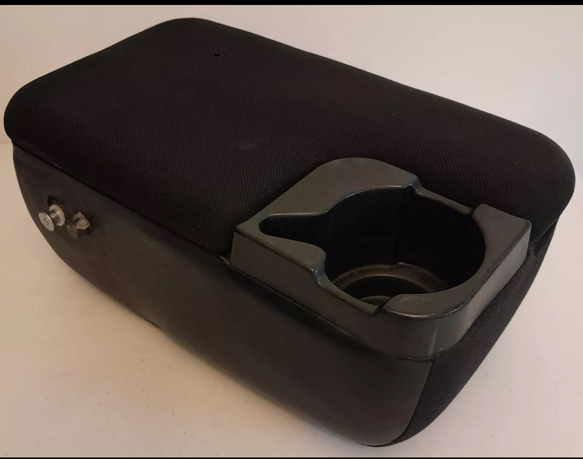

Since buying my 91 Ranger I’ve been a little annoyed with the cupholder situation, especially with the manual it’s just annoying not having cup holders. I was doing some research and I saw that the 98 rangers come with a console that has a cupholder in them. Does anyone know if it’s a direct bolt on?
Console/middle seat for 1991 ranger 60/40 bench
Here’s a pic of the console I am talking about.
I haven't tried it, but I am pretty sure it is NOT. The 2nd gen like yours and mine has a bolt buried way down in the armrest that goes into the driver side frame. The pic above has a shoulder bolt sticking out and if that is the case it would be captured by something on the driver or passenger seat (depending if it is a 60/40 or a 40/60).

That said, I claim it would not be a bolt in solution. If you can do some fab, I bet you could make that center arm-rest work, especially if you have a 2nd gen donor you could splice the 2 frames together and then use the foam and cover from the 3rd/4th gen. (just be sure to get a 60/40 with the bolt on the driver side not a 40/60 with the bolt on the passenger)
I just threw away my original 60/40 seats literally last night, and can tell you the 2nd gen ranger center armrest the frame is entirely encased in foam - so getting the frame out would be destructive.
