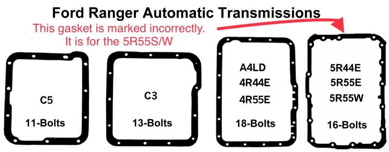

Is this picture inaccurate then? This is what i was going off
The chart is incorrect. Here you go.
