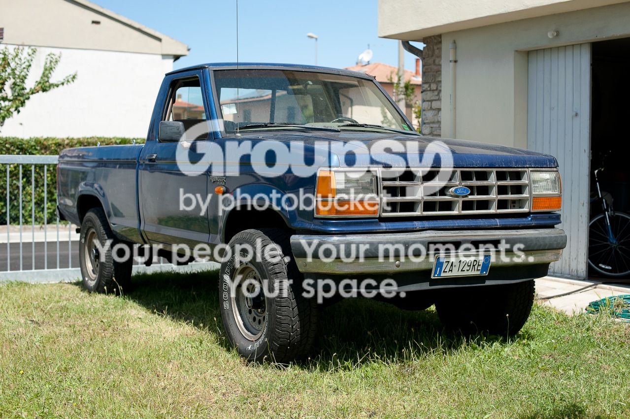

suspensions are differnet from 2wd to 4wd. here is a 92 2wd with leveling kit:
it doesnt say tire size where I foun the pic but those are stock wheels. You can see me hesitance to squeeze 31x10.5's and get no rubbing
That looks like a 4wd to me, you can see the hubs and the diffferential part of the front axle.
