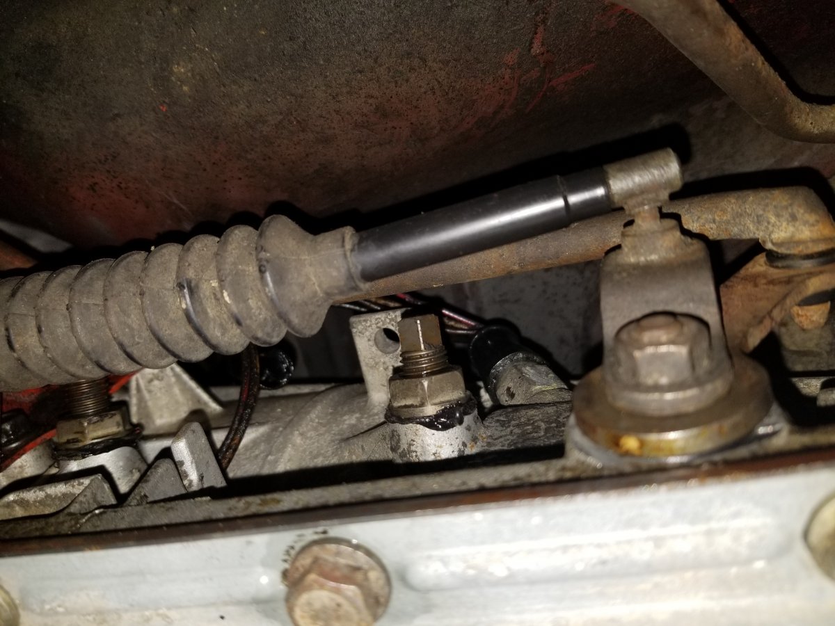

Here is a pic of the connectiins forward of the linkage on my tranny. What does it mean or what isbthe significance of a 2 wire plug and do i have it?

Yes, looks like 2 wires running down into the transmission, just in front of the shifter
The multi wire connector above the shifter is the NSS(neutral safety switch) just FYI, it activates reverse/backup lights and allows starter to work in Park or Neutral
Up to 1988 the A4LD just had one solenoid, so only needed 2 wires, in 1989, a second solenoid was added so it had 3 wires
As shown in previous link: https://www.explorerforum.com/forum...d-specification-chart-from-transgo.39537/full
Lower right corner of image
