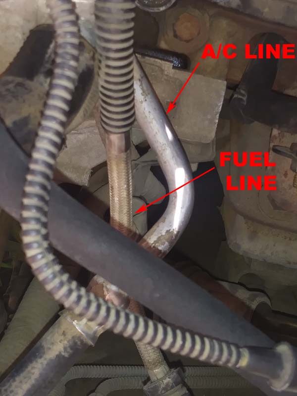

Nearly ready to get started with this, i'm searching and ordering parts now as well as watching various YouTube videos on the subject and of course searching this site over :D
Almost got this down but my two (well technically three) major points of concern are..
Removing the AC/PS Bracket some say I can slide it forward, but looking behind the Compressor the AC Line is wrapped around the Fuel Line (see pic).
I was hoping to get away with not having to disconnect the fuel line as i'll be working in my garage and wanna keep the fuel odor down if possible I understand that means i'll have to remove the injectors from the intake manifold and replace their o rings but i figure that would be easier then dealing with open fuel lines.

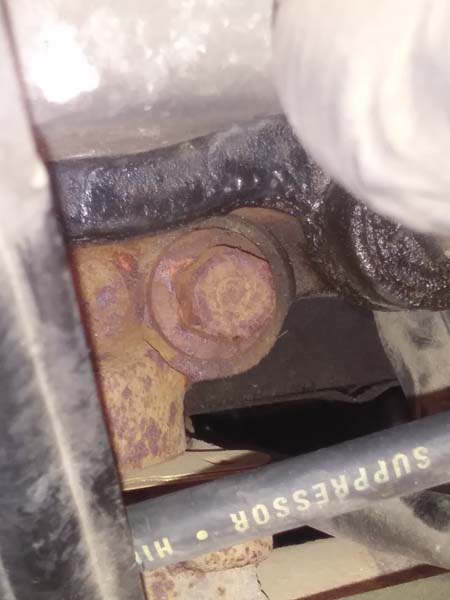

And my other big concern is the head bolts that are outside the valve cover some look pretty rusted and I'm hoping they don't break when I go to take them off. (also have a pic of that). I have an electric impact I can hit em with but if they are on there too tight (and they do look like they have never been removed) I'll have to whip out the breaker bar which is where the breakage concern comes into play.
And of course theres the exhaust manifolds still debating on which route to go with them, I could leave them on the heads and and take them off with the heads out of the truck (might be easier) or try and take them off while they're still on the engine. If I do the first route I'll have to fuss with the Y Pipe but the reason i'm thinking that route is I've already got one broken stud/bolt on the passenger side and that probably means more will break.
Didn't get a pic of the broken exhaust stud/bolt as its hard to get my phone camera down in there and actually take a descent pic but i'm sure most of you have seen those and know what i'm getting at.

Hit the rusted fasteners with PBBlaster every day for a few days before a wrench touches them.

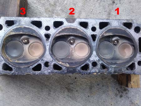

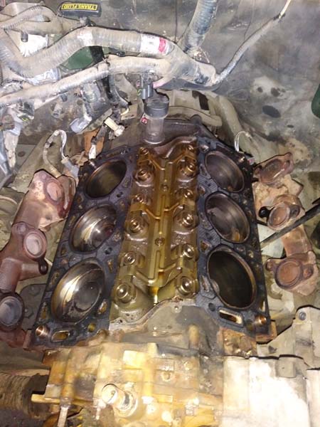

The Verdict
Got the drivers side Cylinder Head off today (those YouTube videos make it look so easy when it was anything but... :shok: ). 2 Exhaust manifold fastners broke but I was kinda expecting that.. Def an exhaust valve problem on Cylinder 6. What concerns me though is Cylinders 4 and 5 don't look any better and infact they all failed the water test tho Cylinder 6 it was pouring out of the exhaust ports so apparently it is the only one bad enough to cause a misfire but the others aren't far behind. 4 and 5 didn't leak AS bad but there still was some leakage. All intake valves appear fine, no water came out of the intake ports so they're sealing at least. On the up side it did not blow a head gasket and I think the bottom end is ok none of the pistons appear clean like they've been steam cleaned all have the usual carbon buildup. Tomorrow the passenger head comes off, i'm curious to see how well the exhaust valves on it are holding up, we shall see.. I'm honestly surprised 4 isn't misfiring or leaking even worse then 6 as it looks like its recessed into the valve seat even further..
Guess now its decision time.. Take the heads to a machine shop and get em reworked or buy reman heads off ebay or Amazon or wherever.

Yeah I was on pins and needles the first time I took the heads off. All those stories out there about scuffing them had me terrified.
For me the passenger side was absolutely perfect and of course it was the first one I took off. I was already gearing up to be mad as hell that I had misdiagnosed my issue and done all that work for nothing, but then I took the driver's side head off. Made me feel much smarter when I saw standing coolant in two of the cylinders.
It's a hard call but for me it was made easier by the reputation of the guys I got my reman'd CH from and the fact that they were only slightly more expensive than getting my old one's machined.
I'm sure either way you go will be fine, keep us posted I'm following along with interest.
Were your pistons clean, like they'd been steamed? I had coolant in 2 cylinders too but that was likely from when I removed the head cause I heard a bunch spill out the back as the head released from the block. My pistons are def not clean they need a bath lol. As for which direction i'm gonna go I really wanna do reman heads and get all new everything in there so hopefully I can get at least 100,000 trouble free miles out of this truck (already has just over 140,000 on the clock). Kinda worried if I just get the heads reworked they may not last as long.

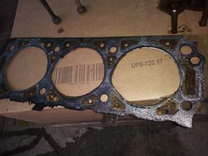

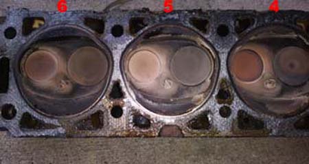

Passenger head came off without much difficulty, only real issue with it was a stupid wiring harness clip on the back, not a whole lot of room to get my cat claw in there. Didn't break any fasteners on the passenger side Exhaust manifold so theres that (gotta love PB Blaster). I still need one though for the very back (that was already broken) and of course the two on the drivers side that I broke yesterday. Damn rust. Now I know how those guys in the rust belt feel lol.
So thats the good, now for the bad the passenger head valves look ok but they leak too all of the exhaust valves failed the water test though not like Cylinder 6 on the other head, and even the Intake Valve on Cylinder 3 is leaking so def glad I went ahead and pulled both heads instead of just the drivers side like I was initially planning. As you can see from the pics the cylinders in the block look good (save for the carboned up pistons) and yes the gaskets are both off although as bad as that surface looks you wouldn't know it lol. Slowly but surely its coming along cleaned out the head bolt holes a bit, don't have an air compressor but that canned air duster stuff that you would use to clean a computer has been my best friend here.. I may need to run a thread chaser in them (tried using a dab of oil on one of the old head bolts and I do feel some binding in there), I've heard of some folks making thread chasers with some of the old head bolts.
Also does anyone know what the heck that white sensor like thing in the back left by the Cam Synchronizer is? Its not in the transmission like I first thought its near the very edge of the block.

Yeah I had a wiring harness on my driver side that was a real surprise when I first went to move the CH and almost missed the nearly invisible grounding line.
I should have bought stock in rust buster before I did mine, 20 years of gunk and garbage. I took the time to clean everything up while I was down there and it made a huge difference afterwards, if there's any leaking I'll be able to actually spot it now. I didn't have too much trouble with the fasteners for my exhaust manifolds but getting them back on proved a bit challenging as they kind of flexed where they met the y-pipe and did not want to go back to seat properly against the new heads. It's pretty common for those to break but I was able to find direct fit replacements at my local ACE hardware, when I put them back in I coated them pretty good with some white lithium grease to help protect them a little better.
Canned air and a shop vac were my best of friends, I bought a case of the stuff and bought a good quality vac with attachments I jury-rigged to fit in specific channels.
The carbon deposits on the cylinders really aren't as terrible as most people make them out to be, yeah the engine is better without them but after cleaning mine I didn't see too much improvement vs the work it took to clean them up. I'd recommend cleaning them but not going overboard. Definitely chase those threads and use paper towels and a shop vac to clear them out, even a little bit of oil or gunk can change torque values by causing binding. I dipped a rolled up paper towel down each bolt hole and saw if any oil or coolant was present and then did it multiple times until it came up clean and plastic wire brushes afterwards (like you'd use for gun cleaning). I cover a lot of this in my HG walkthrough in the tech submissions section, it's not gonna be a 1:1 fit for your engine but the general processes are going to be the same.
Decking the block: was probably the second scariest part of this for me. I saw so many contradictory opinions on how to do it right and what you should "never do" that it was straight up confusing. What I settled on was Acetone & gasoline applied liberally with a plastic razor blade to chase down every single gasket fragment and then used a straight edge and slip gauge to assess flatness. In my case the block was pretty true from the get go so I didn't have to do much, before you go attacking it definitely check it first. Some folks swear by roloc, others by high grit sand paper and others will say "0000 steel wool only" but at the end of the day there's the same two concerns: debris & gouging. When you deck the block still in the engine, the debris you make making it flat will get everywhere, I blocked up all of my cylinders, bolt holes, & channels with oil soaked rags and vacuumed several times after I was finished (a mechanic friend of mine showed me his Barbasol that he keeps in his shop to block those channels, who knew right?).
Key takeaways if you deck the block: Never use steel on, it you will gouge it; Manage that debris, nothing worse than getting it put back together perfectly only to find that some debris is now floating around in your engine.
I did an oil change immediately after swapping my CH and then again after 500 miles. This was to hopefully filter out any debris that might have been lingering in the oil. This was probably the best advice I got through the whole thing.
On the upside if you get reman'd heads then you won't have to worry about the valves :icon_thumby:

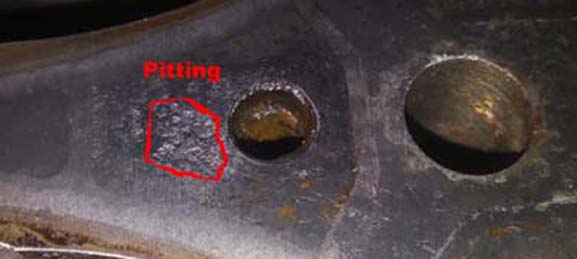

Here are my options.. I got an estimate of $405 to have both heads reworked, this includes the $126 charge to basically thoroughly test the heads and make sure there are no cracks. Or... Buy reman heads from eBay for $310.62 for a pair. https://www.ebay.com/itm/Cylinder-Head-Ford-Taurus-Ranger-3-0L-F6-OHV-98-06-PAIR/273157431386?ssPageName=STRK%3AMEBIDX%3AIT&_trksid=p2060353.m1438.l2649
I know with the remans i'm good to go if I go the machine shop route it's around $95 more IF the heads are good if not I'd be spending the $310.62 on top of the $126... Junk Yard is another route but no guarantees..
As for prepping the block.. :shok:
So far cleaning the engine block surface has been the most time consuming and most challenging part of this whole endeavor, been using a razor blade and the 600 grit sandpaper wiping off constantly with brake cleaner on a rag. I had contemplated buying Roloc bristle discs, some people swear by em others say they'll cause damage to the engine so idk what to make of that (dude at the machine shop was adament about not using those).. I did notice a small amount of pitting near a few of the coolant passages like maybe the coolant got acidic and ate the metal in that area, theres also a matching indentation in the OEM gasket that came off, they aren't deep. The camera makes it look worse then it is the metal around it is smooth.

Tough call on the heads, from an outsider's standpoint it seems like reman'd heads would be the preferred route, bonus points if they come with hardened valve seats (you'd have to contact the supplier to confirm directly). But either reman'd or reworking your current ones seem like better options than junkyard without seriously looking into the salvage.
I'm hesitant to comment on prepping the block due to my own work hasn't given me much hands on experience doing it myself and there are a lot of contradictory methods floating around. I know that those low spots can potentially cause a lower quality seal with the gasket, but the Fel-Pros are supposed to be rather forgiving compared to the OEM versions. You're spot on with the coolant causing that pitting, it's what happens when exhaust gases reach the coolant, turns it acidic and since it's hot it just wreaks havoc on the metal.
So two options before you: Trust the Fel-Pros to seal those low spots or deck the block.
If you go with decking the block then all I can say is have a powerful shop vac handy and manage the debris as much as possible. Stop up those bolt holes, channels, and cylinders some how.
From what I've seen Roloc discs can be amazing and fast... but it depends on the operator. You spend too long in one spot or sneeze at the wrong time and you've just caused yourself a lot of trouble.
For myself I'd opt the traditional hand route: Using a truly flat surface like glass or granite to back your sandpaper/grinding material and make sure it can cover the entire surface at once. Then use suction cups to hold onto the flat backing and then with even pressure go over the surface one stroke at a time. I've seen several instances of people using layout dye to make sure they're hitting everything evenly.

I've heard mixed opinions on decking the block, some say it causes compression issues cause you're lowering the deck height and too much you gotta start using gasket shims :shok: I have heard about the FelPro gaskets being somewhat forgiving but even still i'm concerned about it not holding up more then maybe 50K miles, from what I can tell from closer examination of the OEM Gasket it was on the road to failing.. Fortunatley the fire ring areas on the block all look good so theres that..
Curious Question though.. What about using small amounts of JB Weld in the pitted areas to fill em in, and just using a razor blade and fine sand paper to make it flush with the rest of the block deck? I've read some places and seen a few YouTube videos saying that could help. I've had success with JB Weld in the past plugging a radiator hole more then 10 years ago thats still holding up to this date in our 85 E150, obviously this would be drastically different.
