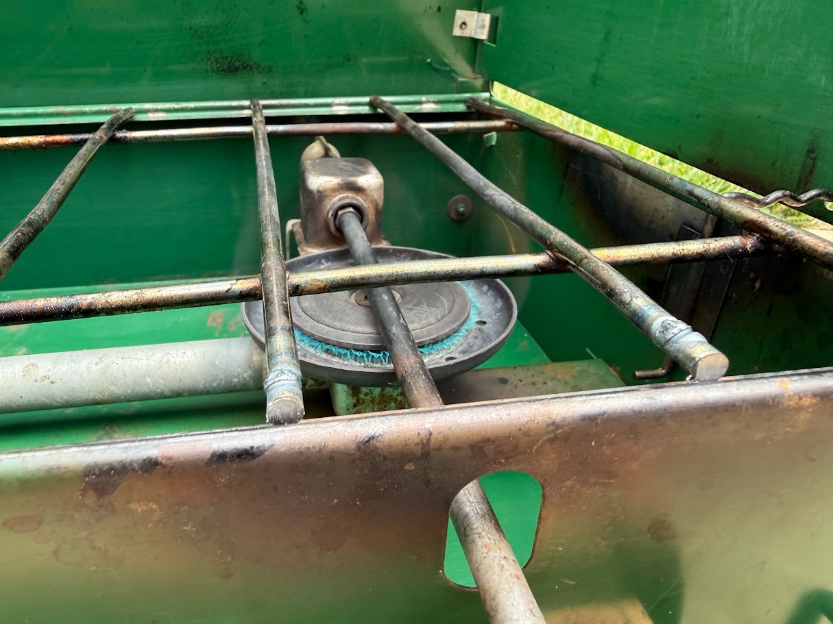

Grate situation resolved. I found this piece of junk propane stove at the thrift store today for $2.50 and harvested the grate off of it. Needed to be modified a bit but it fits OK and probably nobody but me will ever know the difference. The poor donor stove is missing the propane dingle tube, both knobs are broke off and it's filthy... probably end up being patch panels for something and a small amount of scrap metal.

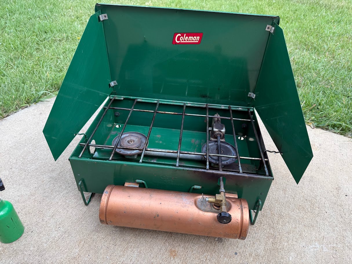

Fueled up the 425 and it runs great as expected!

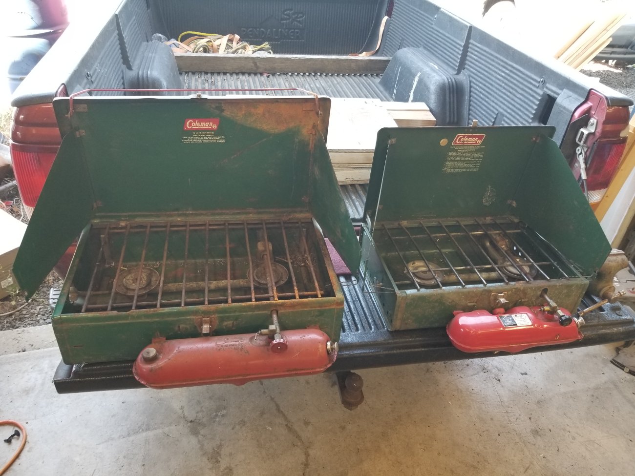

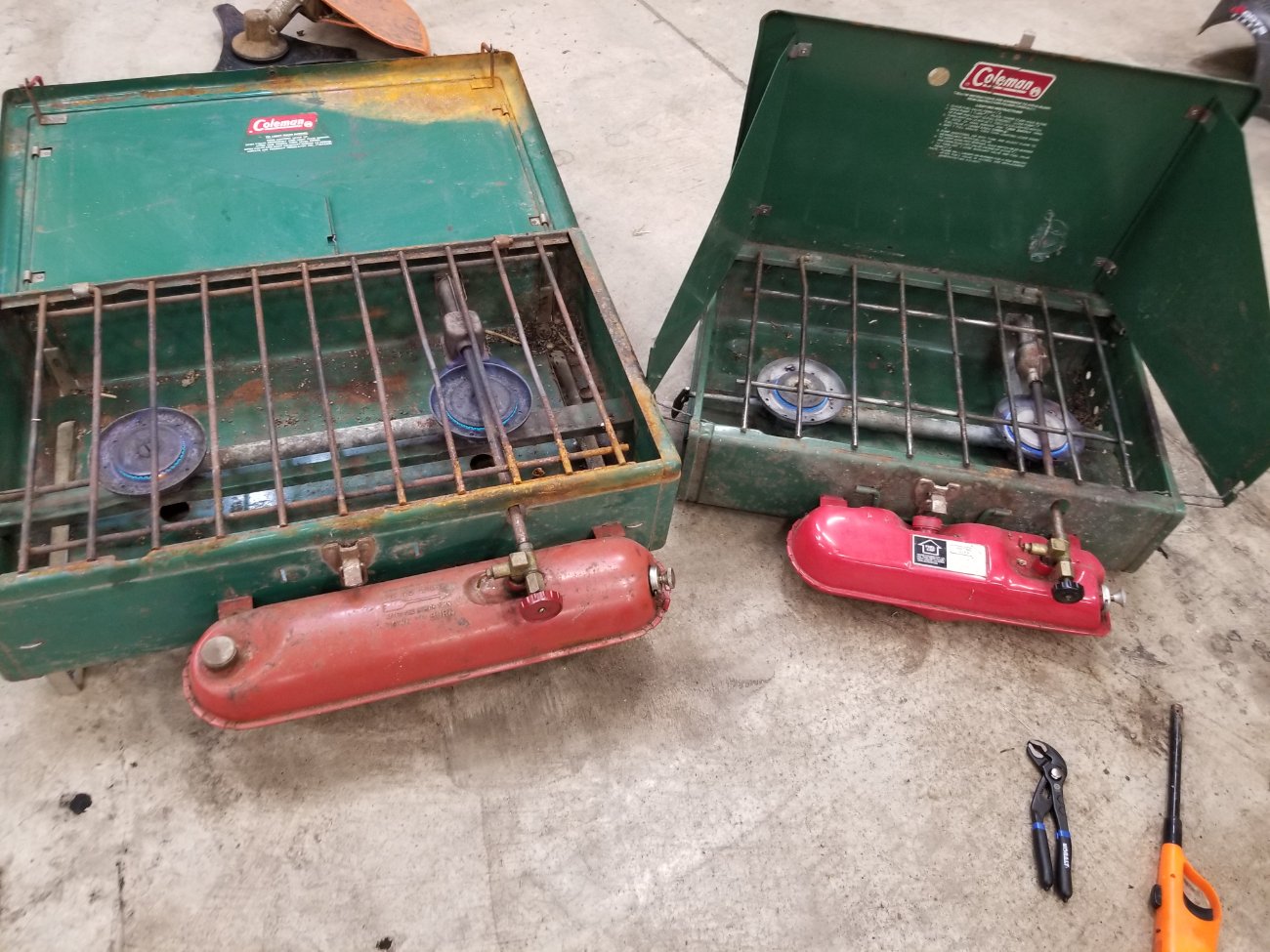

The little single burner wasn't running at full chooch when we were at Carlisle for Ford Nationals. I took apart the vaporizing tube to take a gander at the internals. The cleaning rod had quite a bit of carbon on it. After I go it cleaned and ran a pipe cleaner with some paint thinnner and then denatured alcohol, it was able to get a perculator coffee pot perkulating again. Not as fast as the dual burner stove, but it was able to do it. So, good enough.
