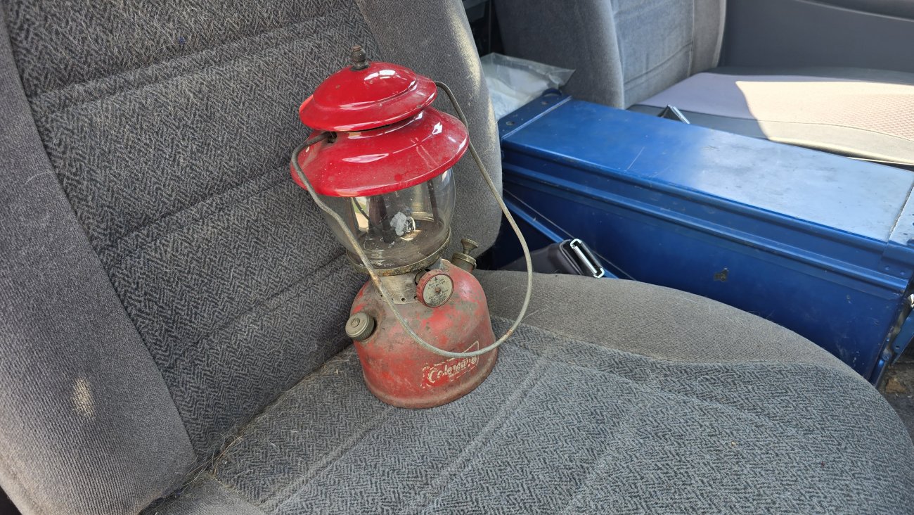

I've been wanting one of these for a while. The smaller size might be easier to pack on trips. Seems like they're usually listed for $80 or more around here. This one was listed for $40. I got it for $35. Needs some cleaning.
The seller buys abandoned storage units and sells the contents. She had a few other lanterns, including a pair of 220's that need globes @$10 for the pair. I almost took them, too. But really don't need them.

Pretty red. Matches my Ranger. Clean that baby up and send it to me!
