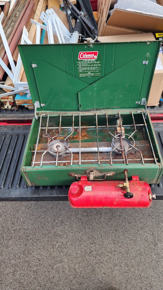

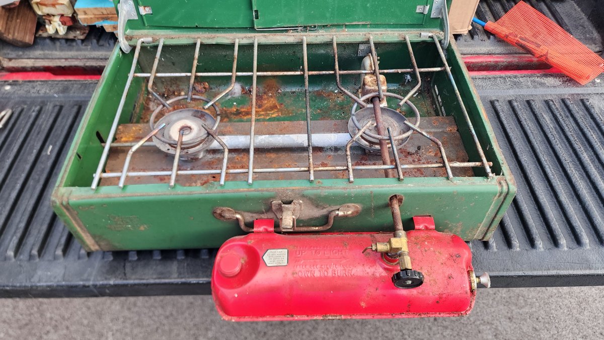

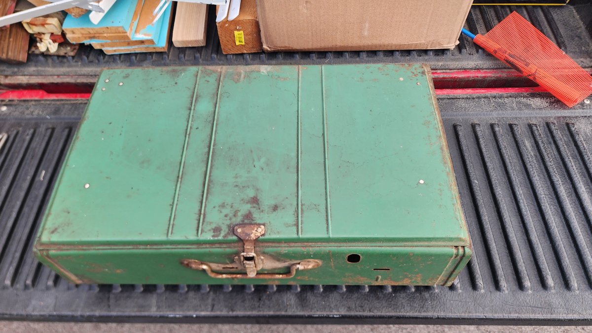

I scored this on FB marketplace for 10 bucks. Still has fuel in the tank, does Coleman fuel keep or should I use it to kill some weeds?

I don't know on the fuel. If in doubt, dump it. Especially since you don't know how old it is.
It seems dual fuel two burner stoves have become a collectible. I saw amazon no longer had them available. So I did some searching. Colemen doesn't have them, nor does Cabela's, Bass Pro, or a hand full of other places that showed up on the search. The single burner mini stove is still being sold but no one other than, say ebay had any listings for a two burner.
I believe campstove fuel is naptha. If so it will be fine.
I might have to test that. We have some naptha at work for cleaning fittings. The call it dry cleaning solvent but the main ingredient is naptha.
It does go bad but it takes a LONG time... if it smells like Coleman fuel it'll be fine. If it smells like rotten gasoline then dump it.

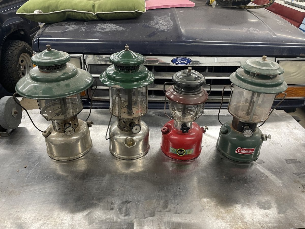

OK... screw it... I bought more lanterns yesterday at a swap meet and now I just have to post them (pre-cleanup of course.)
First two came from the swap meet. I am super stoked about these -

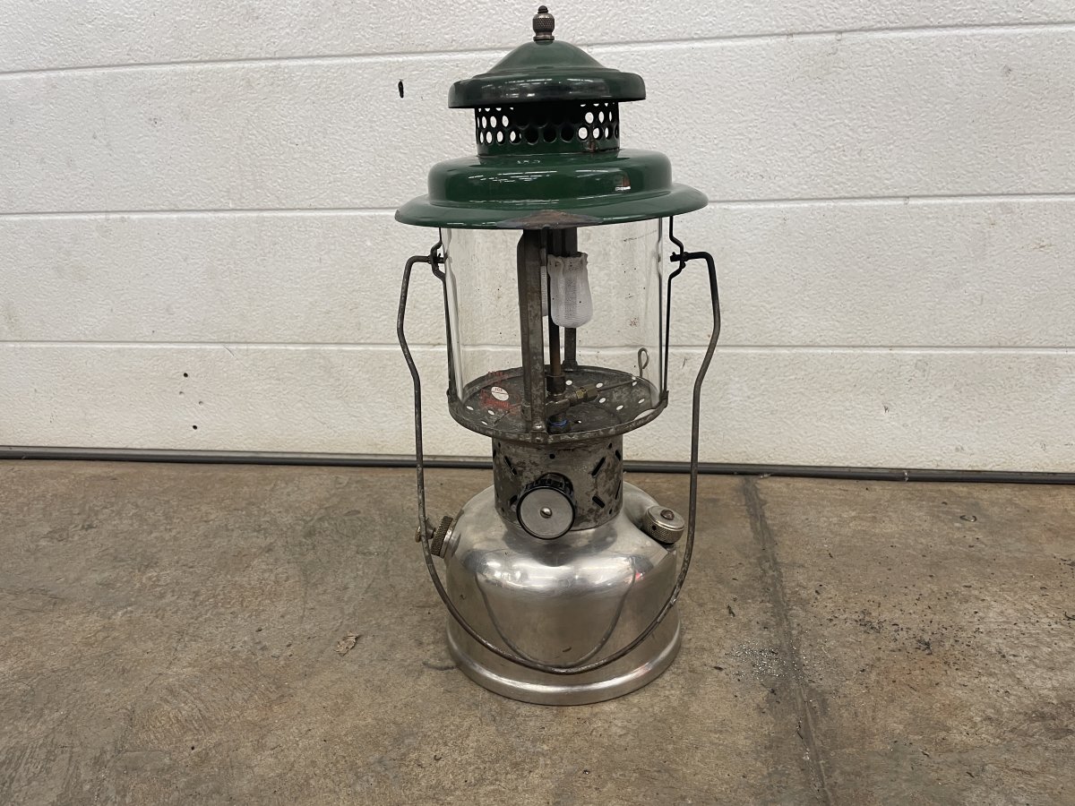

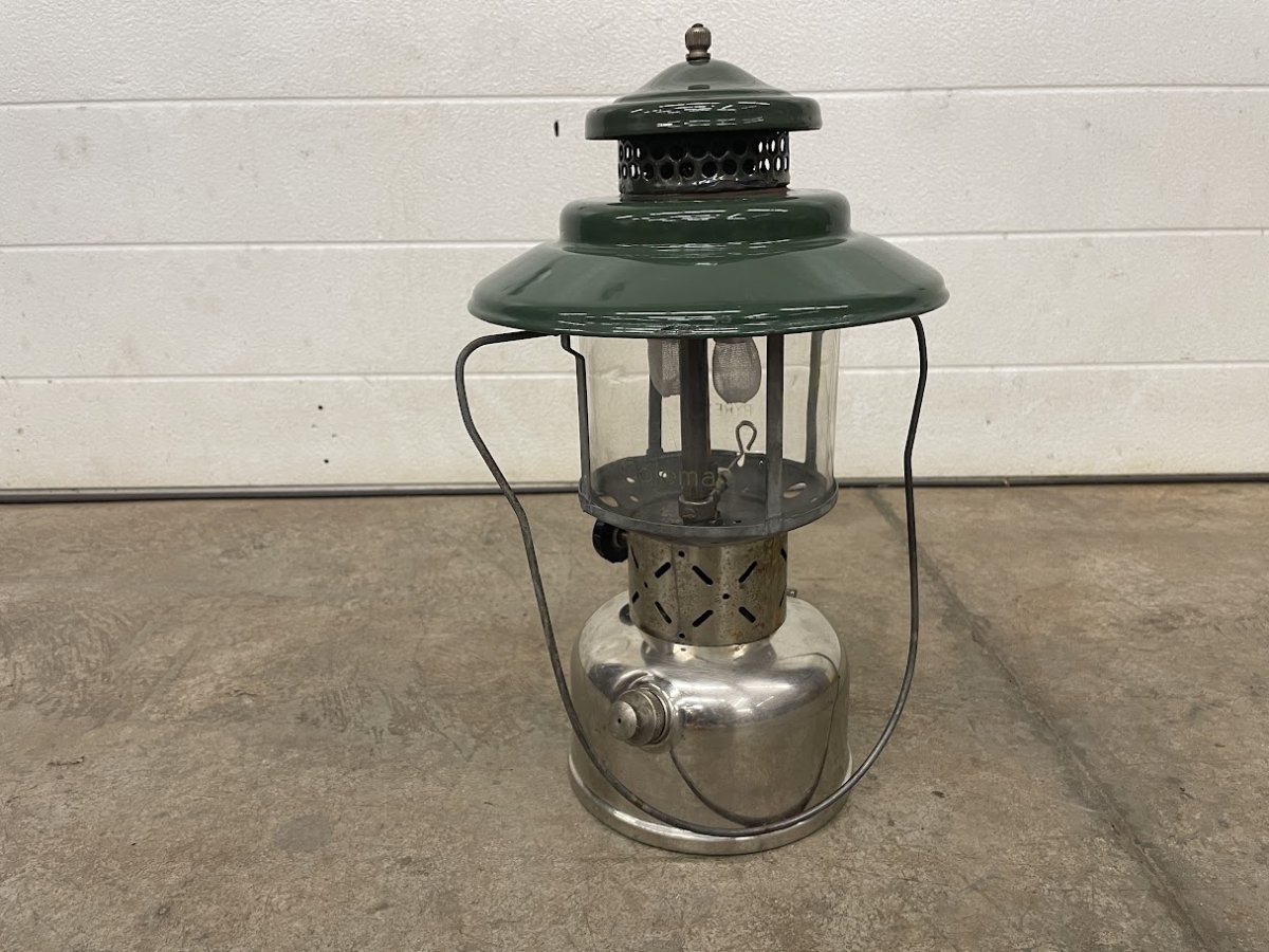

#1 is a 228B (I think) and I am going to tentatively date it at 1939. I believe it has the original globe! Paid $25 for it. Fount is caked in crud... it'll need a very thorough cleaning.
#2 is a 220B (again, I think) and I'm guessing it was made between 1931-37 based on the brass screw in pump and collar with tin/zinc drips on it. The fount is pretty clean on his one but the rest of the lantern is really dirty. Paid $20 for this one.
#3 is a Sears single mantle from the mid 60's I think that's supposed to be blue but someone painted it red. Trying to figure out how to fix that. It's very cool - same upper half as a 200A but a bigger fount - close to 220 size. This one will run with very little effort, it's just a bit dirty on the outside. Paid $4 for it.

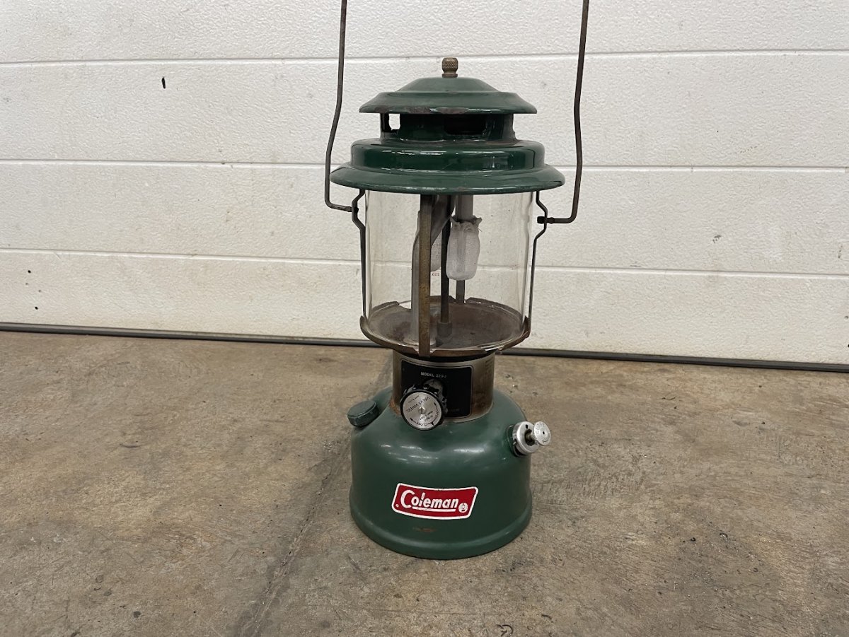

#4, is just a very homely 220J from 1975. I found it at a yard sale on Saturday for $1... it needs some love to say the least but I'll get it running.

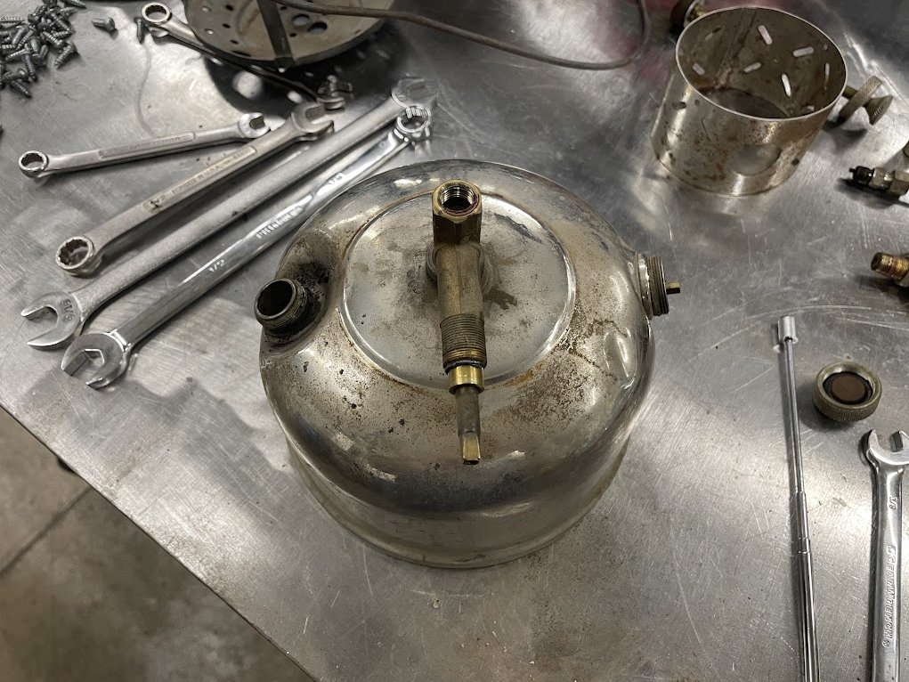

I got the 228 torn down last night. All the brass pieces are soaking in vinegar... I poured some 30% in the fount too and let it sit overnight. Looks like it will clean up pretty well. The valve assembly was a real bear to take apart.

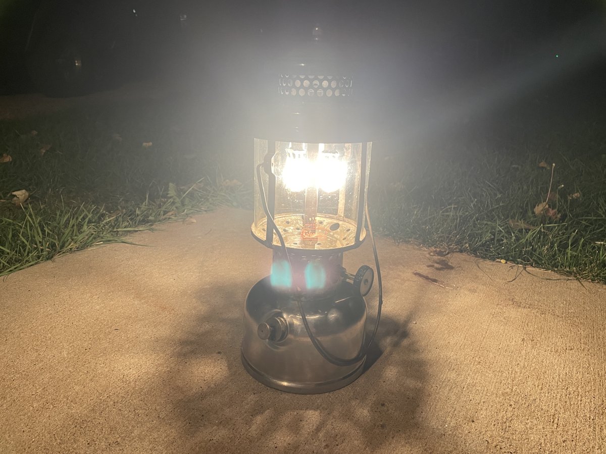

The 228 cleaned up pretty nicely and it runs great! It needed a new generator and the usual cleaning but I am super happy. On to the other three.
