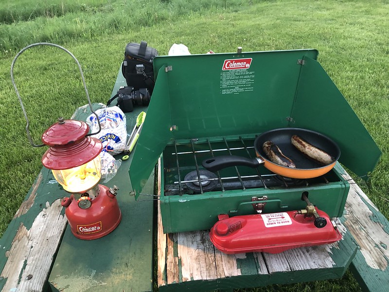

Cooked brats at the lake again, the 200A got to go to the dance this time
I really like the little thing, I wish the tall vent 200A cases were not so stupid expensive. When I get time (ha!) I would like to make a case for it.

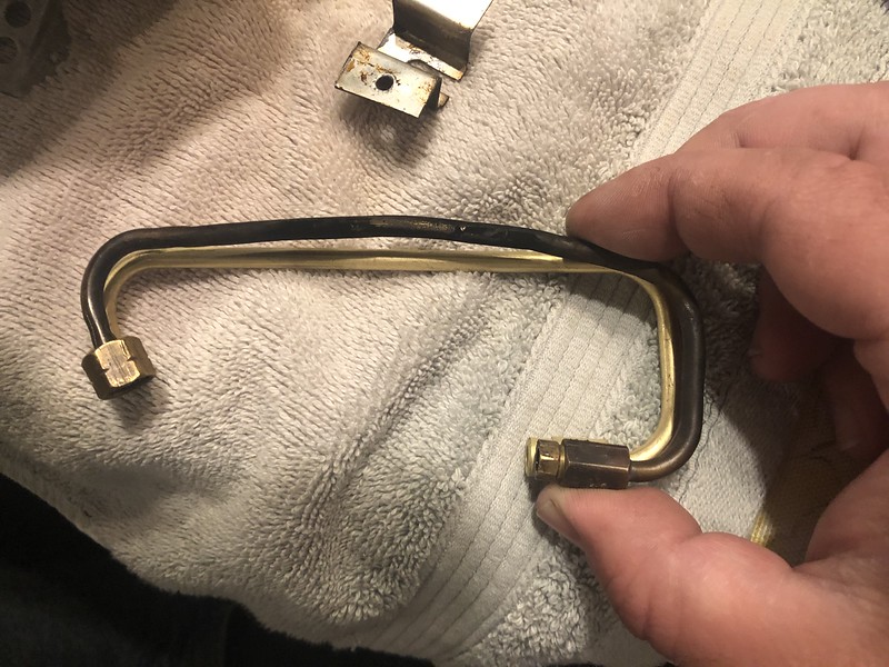

And just like that my $3 stove runs like a new one! ($20 valve and $15 generator sold separately)
It was rather amusing how fast it burned off all the carbon once it got going.

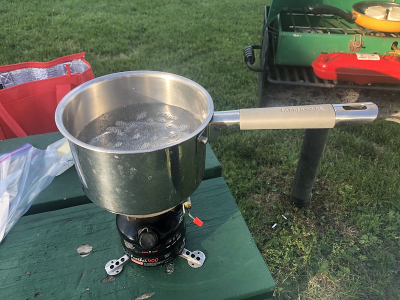

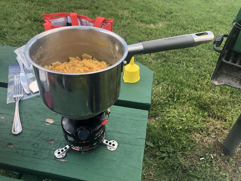

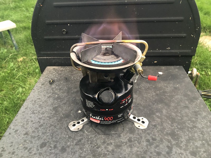

Took it to the lake to stretch its legs a little.
I am really pretty impressed with the heat it was capable of and it seemed to have pretty good temp control. Made for a good pot of macaronis.

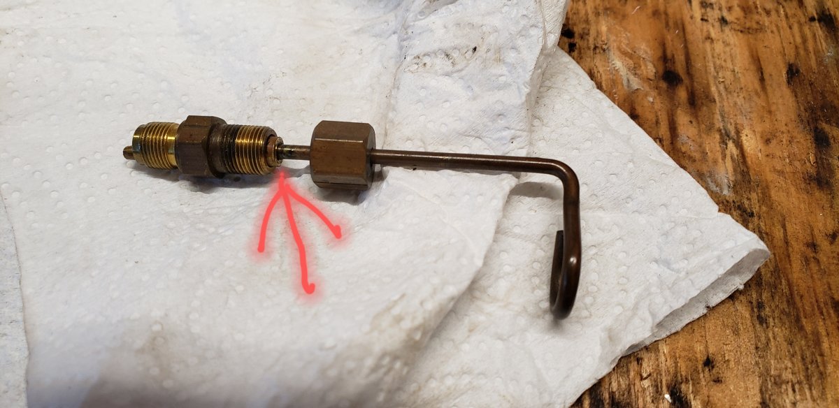

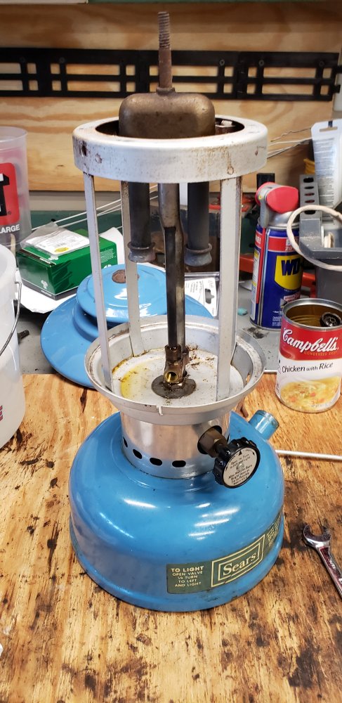

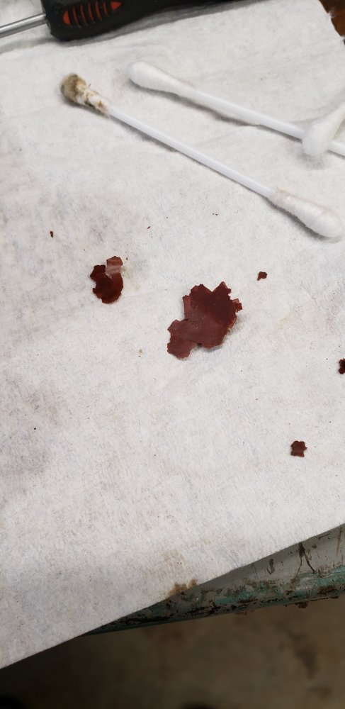

Ok. I'm tearing into my lantern. Should there be any kind of o-ring/packing here? The little handle is stuff to turn, but does rotate ok. Does this come apart any further for cleaning?
I drained the fuel. The tank was full. I saw this flaky residue. But the fuel was clean and clear otherwise. I ran it into a clean container through the Coleman filtered funnel. So maybe I can still use the fuel.
Currently trying to get the rest of it apart to clean. I have the pump leather soaking in neetsfoot oil (see soup can).
I think the cleaning rod crank is an assembly. There is a packing in there and the nut adjusts the pressure on it.
I think that is why my 220J fireballed in its previous life, it was leaking fuel there because the nut had backed off. And that is kind of out of sight to observe leaking fuel too.
Really nice clear picture drawn by a drooling sharpie here I think for your lantern:

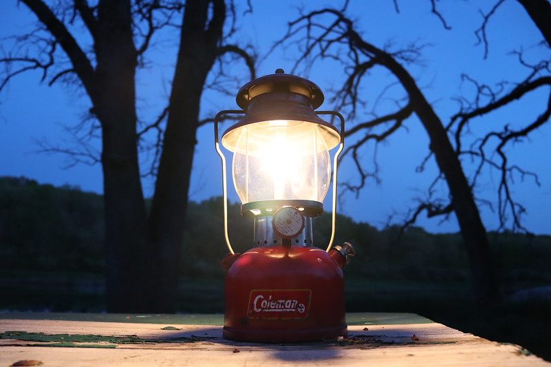

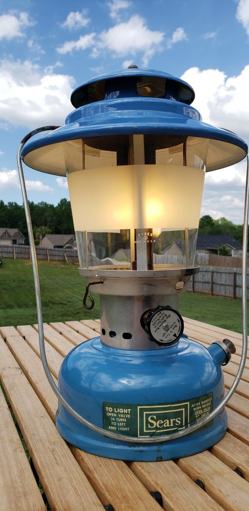

It works! Probably hasn't been used in 10 years or more. Now I need to order mantles.
