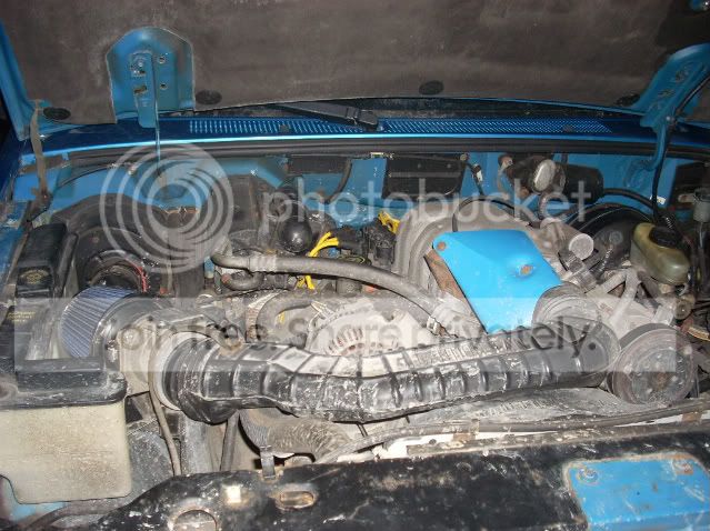

this is what i did
Yup that suckers gonna take in way too much heat, not even know it, then one day your motors gonna blow into a million pieces..Might even make a mushroom cloud!~ *gulp* Not, but maybe. Probably. Better to take air from the wheel well where it's grabbing some fresh air. fo sho
thats an old pic. i made a heat shield for it now and moved the overflow/washer fluid box down alittle allowing more air. if i put it in the wheel well it will just suck up mud and water
