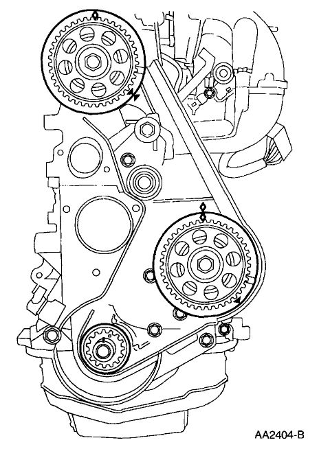

I'm guessing it's the 2.3L in your profile? Does it sound odd when cranking or crank faster than normal? Pull the plastic/rubber plug on the plastic timing cover on the front of the engine about 8" down and see if the belt that is in there is extremely floppy, if so your timing belt broke and is what I would expect, it's not the end of the world, isn't the easiest thing to change but not the hardest either and the engine isn't hurt.
If you want to tackle it yourself, I would start by taking the fan off while the belt is on so you can get the 4 bolts loose, then take the belt off, then take off the power steering pump bracket (don't remember if it is 3 or 4 bolts, all from the side), take the crank bolt out (put a breaker bar and socket on the bolt head and rest it against the bottom of the passenger side frame rail then bump the starter), then pull the crank pulley off and timing cover. I recommend getting a belt kit with tensioner so take the tensioner off at this point, it's spring loaded, you can use a claw hammer around the spring to pry it and unload the spring. For reassembly put the new tensioner on and lock it in fully compressed then put the belt on aligned as in the picture below:

On Sunday I saw it was the timing belt that broke off, so I went and got a new one in a kit like you said and replaced it. It took a few times pputting the belt on and having the gears lined up like they were supposed to but eventually got it back together with a new timing belt. However it still wouldn't start.

Update, the truck is back to running! Took another look at it last weekend and saw I had lined up the crankshaft gear in the wrong position, so got that fixed. It seems to idle pretty high now though, probably about 1400-1500 rpm for a few seconds and back down to 1000 rpm after slowing down.
