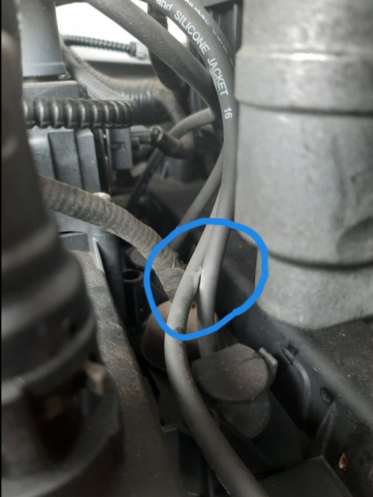

Cheap spark plug wire arc.
I wonder if the arcing hurt the coil pack any. :dunno:
Truck still runs fine so Im guessing not... not gonna drive it till the new wires come in though.
As long as the spark releases it shouldn't hurt the coil pack. I did have one coil die when a plug wire popped off and had no where for the spark to go to. This was a single coil set up on a 4 cylinder and not coil packs though.

Here's the problem... i seperated the wires for now
A slight misfire on a wire shouldnt hurt the coil at all. If a wire comes off the coil like Bgunner said, that can cause a coil to get a burn spot that can misfire even after you reinstall the wire. If it still runs fine, the coil is ok.

I seperated them, but the damage is done to the wires so im not trying to salvage them. I got wire separators for the new motorcraft wires.
