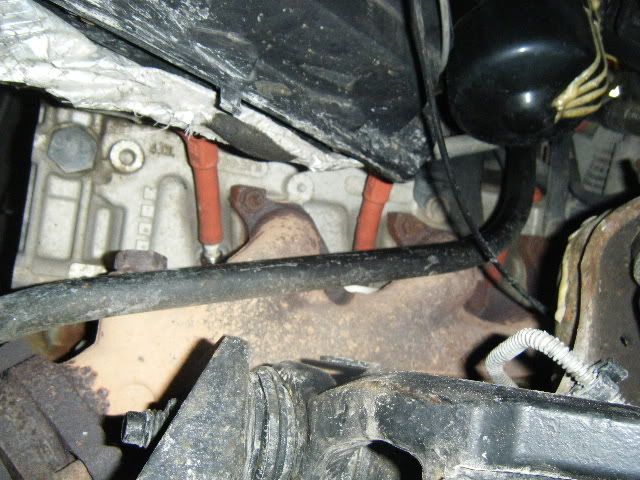

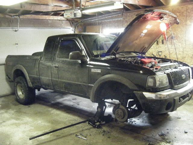

yep, through the wheel wells. next to impossbile to get to from the top
Don't be scared, it's super easy.
Step one, pull passenger wheel and inner fender plastics

Step two, remove, they are right there and don't get any easier.

Driver side you can get from the top.
This is the setup I use at work to change the right side plugs, just pull the inner fenders and they are right in front of you.

I take it the way to remove the inner fender is to remove the 3 bolts up front, and the two that run up the middle of the wheel well, and then it should come out? After I have it jacked up and the wheel removed of course.
Finally completed it, it was almost right at a 3 hour job. Went thru the passenger side by removing the inner fender. Driver side from the top. Only trouble was getting the plug wire boots loose (I believe it still had the factory plugs/wires), especially the middle one on the passenger side, with the trans dipstick tube right in the way. Sprayed the boots to kingdom come with WD40, to help aid in the removal process. Of course made sure to coat the threads of the new ones with anti-seize.

The obstructions(Heater radiator, etc.) on my 2003 4.0 SOHC are much lower than that pictured.
