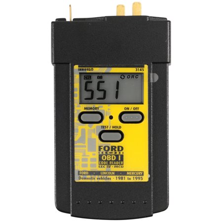

Or go the easy route and buy this...
20 bucks online. 30 in the stores. Ive used mine extensivly on my 87.
does this obd reader need any wire/pigtail to connect it to the truck?
No, that reader is for OBD1, 1994 and earlier Rangers, which have a wire connector in the engine bay that plugs into that reader

well, i bought one of those OBD things, just like the one pictured a couple of replies back. followed the directions (there's a first for everything) and am no further ahead.
first time thru it would not believe that i have a 2.9 and said '4 cyl'. i didn't notice that as i was testing so i kept going. got a 41, 74 and 77 code. something with the new O2 sensor, brake switch problem, and operator error-didn't get from passenger side fender to gas pedal fast enough. that's when i saw the 4 cyl light.
took out the batteries to zero the reader and started over. got the 6 cly sign, all code 10 and 11's and nothing else.
i did check the timing with the reader set up; 31 or 32 degrees, which is where it should be. after that it just shut itself off and saved nothing.
