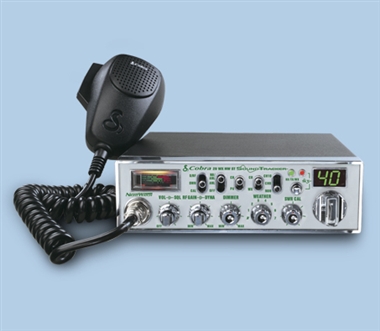

I have a Cobra 29 Army Edition ($70 on sale) and a Wilson 2000 trucker antenna... great setup, routinely get 6+ miles of transmit out of it, haven't had the chance to test further but I know I can do it.
If you're going to get a CB, don't skimp on the antenna...
