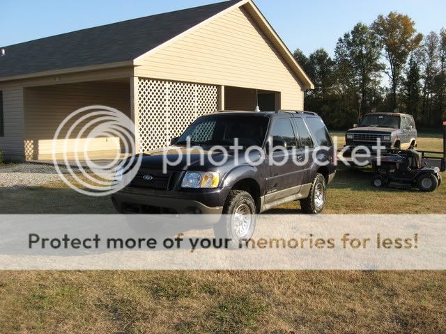

i used a magnetic mount in the middle of my roof. sorry, this was the best pic i could find
ran the wire through the rear "wing" window.
