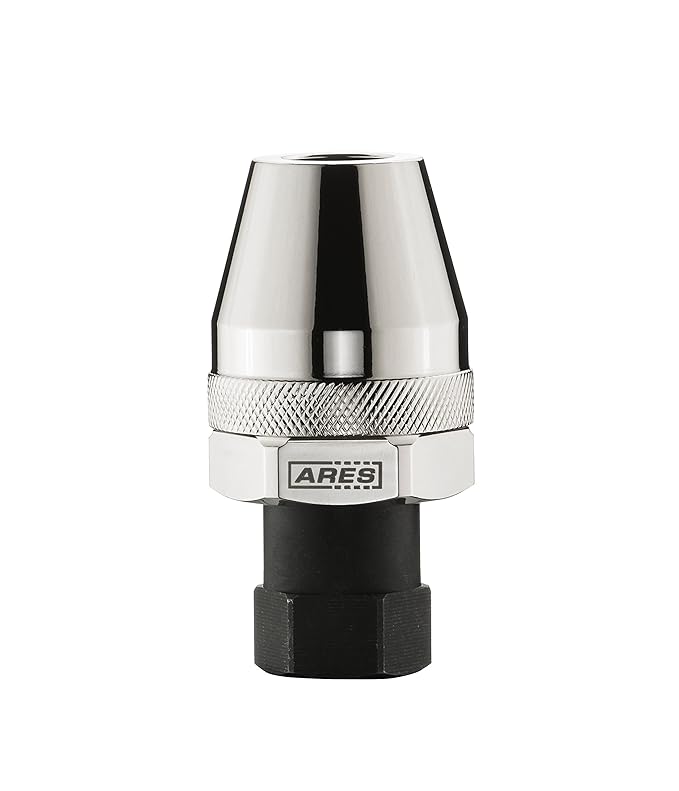

I had to use a tool like this to remove one of the broken studs. The other one was broken flush to the flange and I had to use a long drill bit to drill it out and use an easy out.
For a stud left is a head, with a threaded shank under the surface, this tool is wonderful. For Josh's situation I have found a hammer to be more useful.
