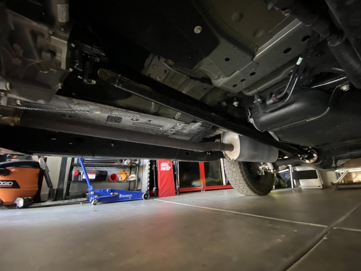

Here's our 2019 SuperCab. It has a 2 piece driveshaft
Carrier Bearing
  • Carrier Bearing

The only single driveshaft 2019-2021 North American Rangers are one's that have been modified by their owners. Some folks are doing that after they have lifted their trucks and the driveshaft angles have caused vibration issues.
It’s done. One piece driveshaft!
This is not my truck..

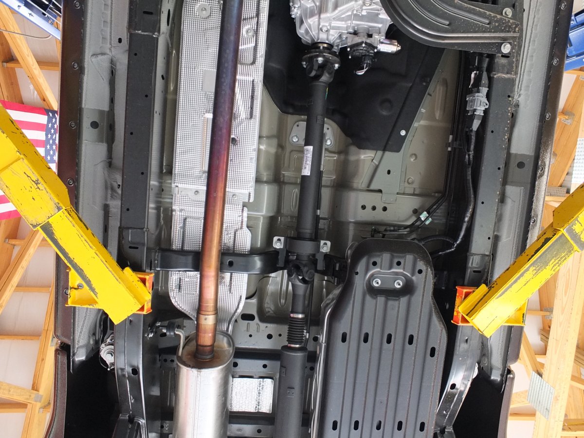

I’m going to take everyone’s word on faith on this one. But curiosity is going to kill this cat. So, when I get home, I’m gonna have to look.
I’ve had vehicles with both. So, it makes no difference to me. The CR-Vs I had never had an issue with the carrier bearing. Just the u-joints.
Yep! Tunnel vision me. There IS. a carrier bearing up in there!
