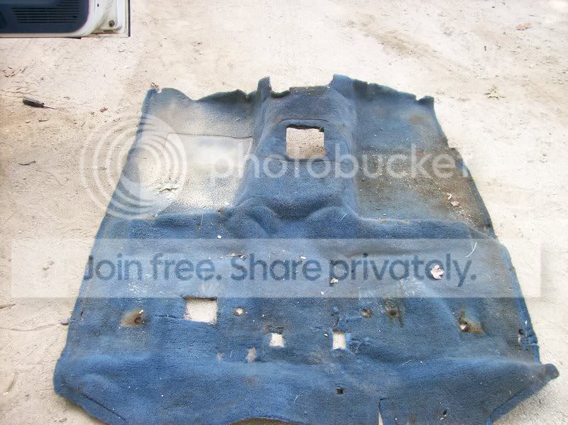

Hey, I have a 1993 Ford ranger that i bought not to long ago and the carpet has always been dirty and has always bothered me. i don't think the previous owner knew what a vacuum was so i did what anybody would do. I went online and priced out a carpet and it was $109 but i decided not to spend that and spend my time cleaning the carpet that was already in my truck. Here are some pics of my journey.
Here is the carpet before i started
Pulled the carpet out of my truck and i found this underneath. Surface Rust. Its not that bad but i will sand down all the rust and undercoat the floor before i put it back together just for the added protection :damnit1:
:tease:
I took the carpet out of the truck and couldn't believe how dirt this thing really was.
I next put carpet cleaner on the carpet and let it soak in for about 10 min. I pressured washed the whole carpet and the dirt that came out of the carpet was amazing. The water was brown because of all the dirt that came out of it. :icon_thumby: The carpet is drying in my garage right now and will have pics of the finished project tomorrow.

Amazing how much crud they accumulate over the years...mine were so waterlogged they weighed about 80Lbs...when they dried out I got way better gas mileage...did you clean out the floor pans too? Those rust spots can turn ugly really fast...had the panels rot out of my Tempo within a few years...
Yea I am going to sand all the rust down and hit all my floor pans and stuff with rubberized undercoat just to help with it. My whole under my truck is all undercoated and that is the last piece. Yea when my carpet was went after i pressure washed it it must oh weighed like 90 lbs because it was soaked. It took to of use to put it on top of the trashcan to let it dry lol. Later today I am going to make sure the carpet is dry and after i undercoat it put the carpet back in. Pics will sure to follow.

that is some nasty carpet, on those rust areas after you sand the surface but before you undercoat it, i would advise you put a good quality rust treatment down first. if you have it available where you are at i would suggest OSPHO[sp] or something simular to prime and seal the rust areas and if you plan on undercoating the entire floorpan you will want to rough up the entire surface to promote better adhesion [ they don't tell you that on the can but i found out through trial and error] and then put down your rust treatment prior to undercoating, and if you put down 3-4 coats allowing one hour dry time between coats and then 24 hours cure time before putting carpet back in it will also give a little sound deadening quality too.

My floor was similar to yours on my first Ranger...and I was seriously considering dumping the carpet and putting in plain old rubber...but I couldn't find one that wasn't ripped (I now know they can be bought though)...
