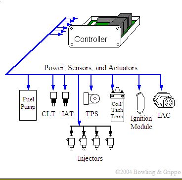

You want complicated?
Carb? EFI? What to choose.
You want simple?
Get THIS BOOK and learn about EEC and you'll have a leg to stand on. I thoroughly understand both.
A basic carb would be air rushing by a hole and the low pressure across the mouth of that hole draws fuel into the stream of passing air. The other 400 parts on the carb I showed above are patches to try to get the method to work well. There are multiple patches to try and make the transition from idle to full power; patches to keep the engine from suddnely shutting off if the throttle is released; patches to crudely enrich the mixture so it will start and then run while cold; patces to crudely enrich the mixture so you can stomp the pedal to the floor without it going lean and blowing the aircleaner off. There are patches to keep the fuel from sloshing away from the jets on corners and bumps and hills; patches to increase the airspeed at low rpms so it will actually draw fuel, while then trying to slow it back down at high rpms so the airstream will not go turbulent and stop metering altogether. There are patches on top of patches on top of patches on top of patches.
EFI is clean and simple. Solid state components that are so reliable you don't even know they exist. Electromagentic components just as reliable. There's about a dozen wires connecting it all together. It adjusts for differnet weather, altitudes and even fuel characteristics--something a carb can't do with even another 100 patches on it. It doesn't stall on hills, it does a way better job of atomizing the fuel--you don't have to go artifically rich because its sprayed right at the port, not released into the airstream a foot and 2 90-degree angles up stream.
You want simple?
