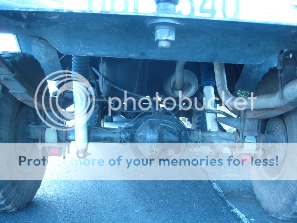

CAN U PLEASE TELL ME WHAT KIND OF FRONT END THIS IS
AND WHAT KIND OF BACK END THIS IS
the front is the ford twin traction beam. im not for sure what the rear is but ill take a guess and say an 8.8 outa an exploder maybe?
front is a dana 28, the rear looks like a ford 7.5.
D28 with a steering system in serious need of a longer ptiman arm..
7.5 with lift springs, factory blocks and traction bars.
haha maybe next time i will pay attention and count the bolts on the front lol
Either skyjacker or superlift. Superlift also has a superrunner steering set up but its expesive. looks like you need the biggest drop pitman arm they have.
