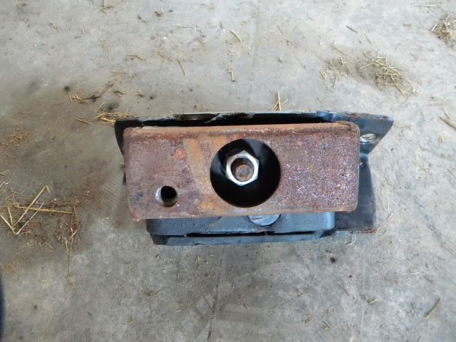

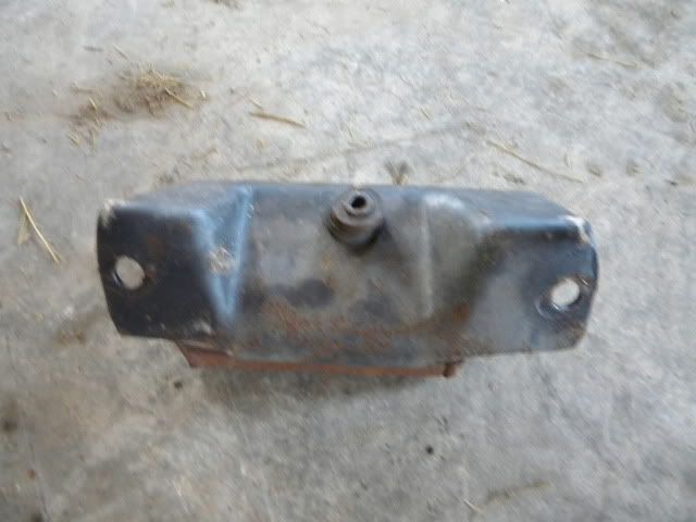

I got these in a deal with alot of other parts for swapping a V8... I am in the middle of swapping to a V8 in the bronco right now and I am pretty sure these must be for a 2 wheel drive swap. If you need more pictures let me know.
They look like some kind of stock V8 mount bolted up to some thin adapter.
Any information would be appreciated.
Well they are for a Small Block Ford 289, 302, 351w-c and as to what chassis I dont really know off hand. Could be some kind of swap kit type adapter bolted to them.

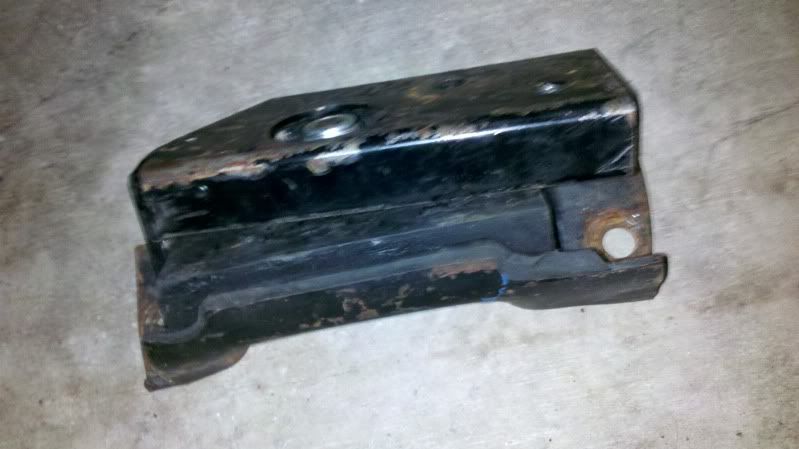

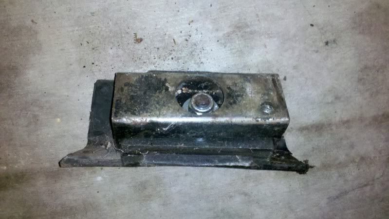

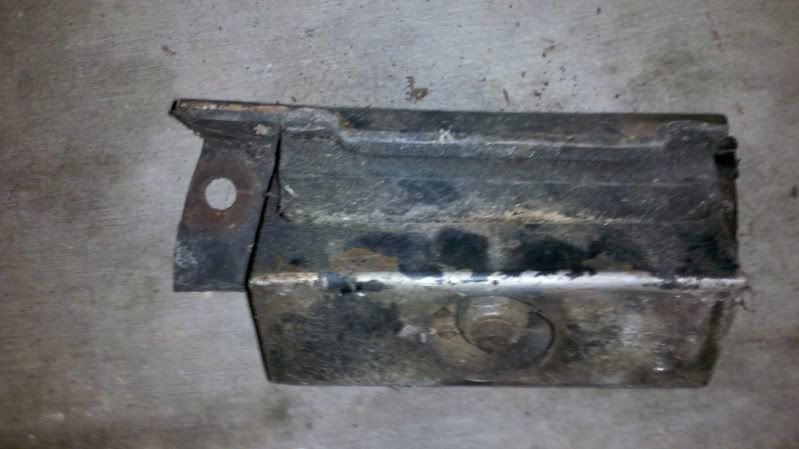

They look like Total performance 351w swap mounts to me. I'll try to post a pic of the ones i got from them for you to compare.
I only have 1 of them off the engine right now. If you want pics of the other 1 i can get them but it might be awhile.
Looks to me to be the same as yours.
looks alike to me too. Do you by chance have any information of what application those brackets are to be used? you say they are 351 Total Performance mounts.... I did a google search and didn't come up with anything really useful.
They are used to put a 302 or 351w in a ranger. Total Performance does not make swap stuff any more so i dont know what you could use for exhaust on a 351w swap. For a 302 you could get by with using try-y's possibly.
