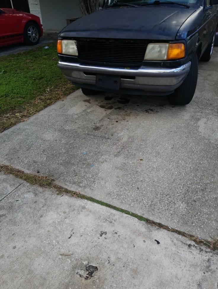

Specifically the front bumper. I want to wire in the fog lights.
I just got a grille and still have to put in the upper, so I wouldnt want to change the top half.
Random thought. What about that hood? It looks so much nicer
Sent from my SM-N950U using Tapatalk
I know entire front clip swaps are possible, but I don't know exactly what is involved on that year.
Except for a redesign of the firewall for 95 the cab itself changed very little from 93 on.
There was actually a fog light valance for that year truck.
To swap the bumper you would have to make custom brackets, the frame ends are different between the i-beam and control arm trucks.
