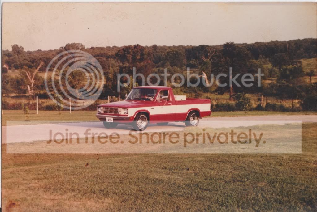

Just for kicks, I found an old pic of the truck and scanned it. Here it is just days after getting a fresh paint job. If you look close, you can see the tailpipe just behind the rear tire. Had one just like it on the other side as well....

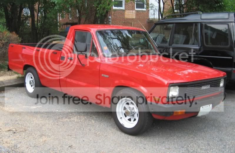

The one I'm getting looks essentially like this-
Hard to say really. The exhaust was done before the carb, and it seemed to make a lot of difference. Of course, the factory cat was rather restrictive to begin with, and was beggining to plug up. Since it used a dual inlet/single outlet cat, I just cut it off and had an exhaust shop build the system. I wanted them to use the stock pipe size (1.5-1.75") but they didn't have anything smaller than 2" OD, so I just went with that.
Other than a long bed and different grill/headlights/turn signals, that's almost exactly what my truck was. Mine started life as a generic white with steel wheels and dog dish hub caps. I saw it as a "Clean canvas" and proceeded to make it what I wanted......
