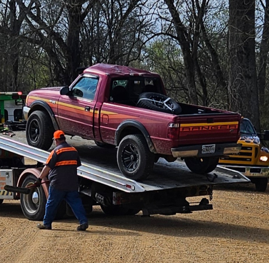

Really long story so I'll make it as short as possible. My son has a 2003 regular cab swb Ranger, just had the trans replaced about 2 months ago then he rolled it last weekend. He luckily walked away from it without a scratch, seat belts save lives! I have a 1998 Ranger with a bad 3.0 and bad trans but the truck is otherwise pretty mint! I'm wondering if the 03 2.3 and trans will swap to the 98 extended cab swb. If so what all will be required to pull from the 03 other than the obvious and harness? PATS, steering column, instrument cluster?
Included a pic of his truck because it sure was pretty and, other than the cab, not horribly damaged despite being on its top.
