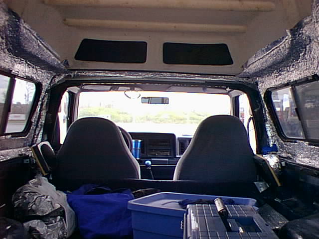

OK...don't laugh...but when I cut the back out of my first Ranger I put a cap on and tried insulating it...worked out pretty good and it would have been way better if I had put a secondary heater into the bed...but it was still pretty darned cold in the winter...especially the nights when it got down to -30...
Here is a pic of the partially finished cap...

I had pieced together plywood pieces that were wrapped in the trunk liner and underpad from several old Tempos (because I happened to have had one at the time and this stuff is good insulation), and had covered the entire inside with that heat reflector material...it wasn't too bad, but because the bed and cab are mounted separately they tended to flex a bit and this caused some issues with gaps...

It would make a great trail rig, but I don't have any more pics of the build...what I did was remove the rear window, and cut down on the rear of the cab and the front of the bed about 6" and folded the piece over and then bolted the two together...it left enough of the cab wall to provide a bit of stability because when the rear wall is removed the cab structural integrity is compromised...
If I was going to do it again I would either use a BII body or just use a BII because it's already done...just a bit shorter than the Ranger bed

i would give the cab 1 inch of lift and place rubber bushings/body mounts under bed, thats just me, being the cab has body mounts and the bed is directly bolted down, then probally run a 1/4 inch plate bolted to the floor of the bed and cab on the underside, and brace the roof somehow(may not be needed after the above)
