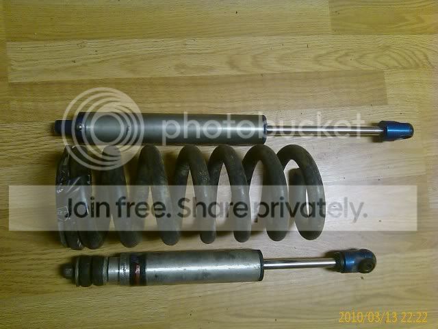

imo the kit above is a better buy. you get better shocks (they're rebuildable and revalvable), a new lower control arm that is boxed, new upper control arm, a fabricated spindle, better springs (the camburg ones like to wear out and sag so you don't get any lift from them), all hardware and limit straps, plus the best thing is full heim steering, a $400 upgrade over the camburg kit that still retains the stock outer tie rod. for the OP who spends more time off road than on, this is my choice for the way to go.

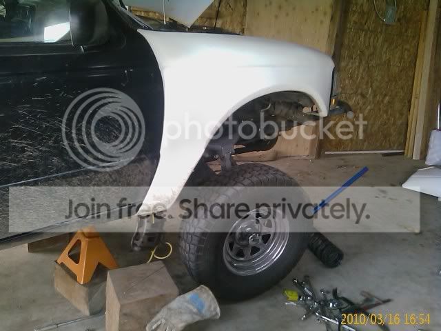

i once had the dream to have the camburg kit but that was two years ago. i ended up with the bms kit. i love it i will never go back to a stock lower.
you would get the lower shock.

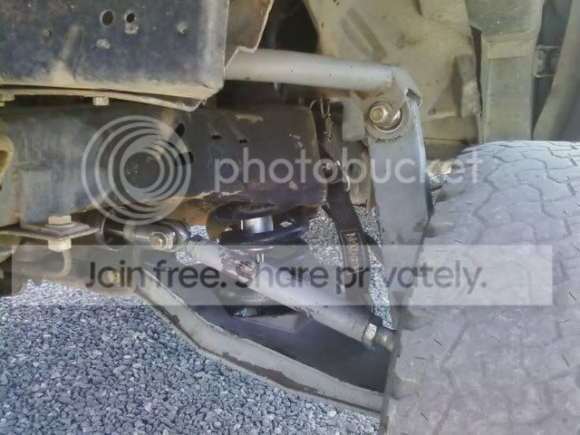

bumped in the first pic and strapped in the last pic. pulling a full 13"
over all. when i first installed the kit.
