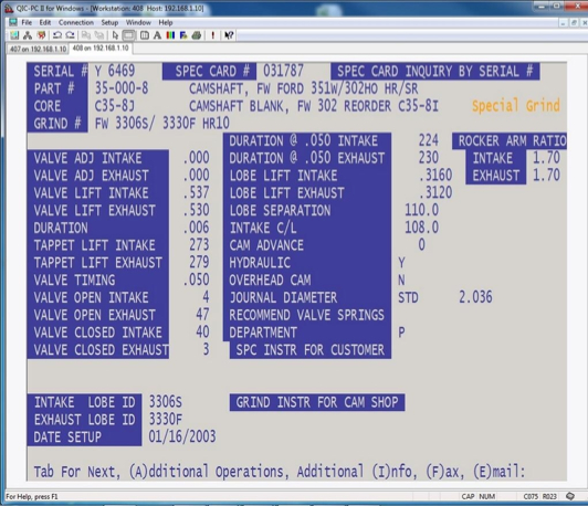

it is pretty close to an e303. where do yall think it will center my power and torque bands?
01 explorer 5.0, 9.5~9.7:1 cr, stock intake with polished gt-40p heads, bored to 306
