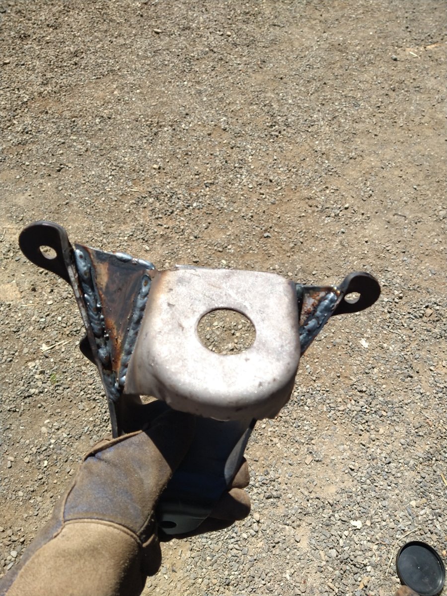

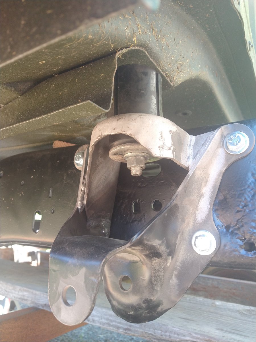

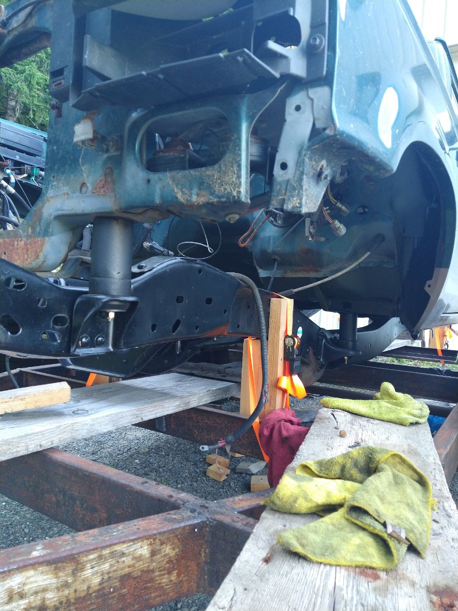

mine is a second gen, but I put an extra cab body on a regular cab short box frame. It ended up that the rear cab mount sits about in the middle of the front leaf spring hanger for the rear axle. I just grafted the body mount into the spring hanger and called it good. To make the cab level it ends up with around a 3" body lift in the front, with no lift on the rear most body mount, due to how the frame rises up to go over the rear axle.
Little bit of fab work should make it happen
