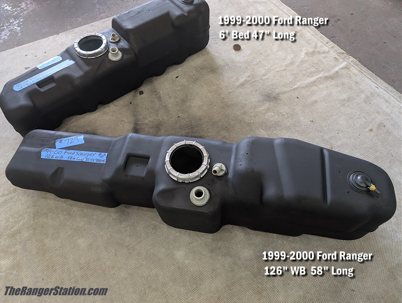

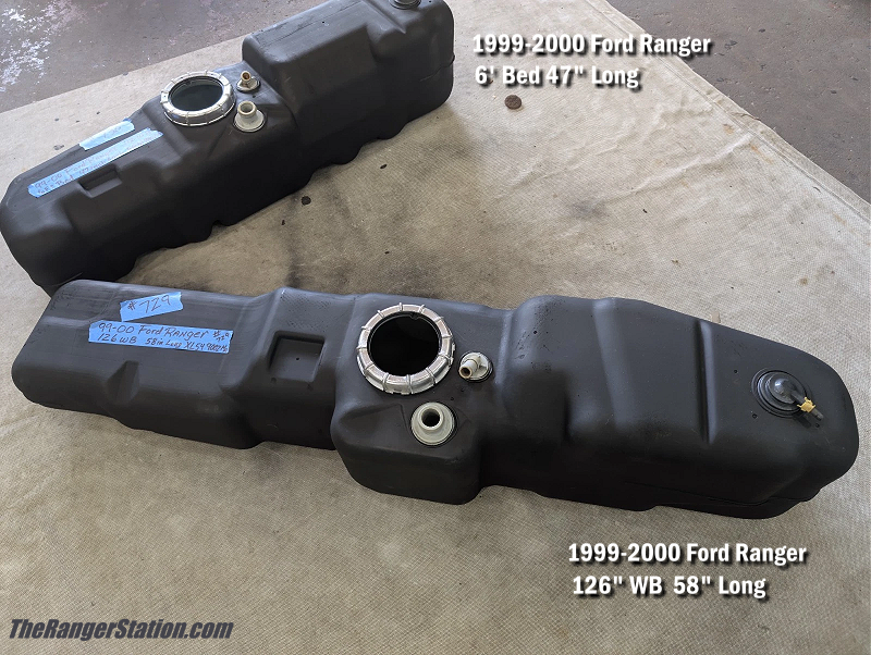

I had trouble finding any information listing actual dimensions of showing any size comparisons between Ford Ranger fuel tanks.
The owner's manual for 2000 Ford Ranger lists (3) fuel tank capacities:
Regular cab (Short wheelbase) 62.4L (16.5gallons)
Regular cab (Long wheelbase) 75.7L (20.0gallons)
SuperCab 73.8L (19.5gallons)
I found an eBay seller (77radrich_newoldstock4sale) that had a small variety of Ford Ranger fuel tanks listed and actually had the lengths listed for each one.
I'm pretty sure what you're looking at in that photo is a 16.5-gallon (AKA 17-gallon) fuel tank (top) and a 19.5-gallon (usually just called a 20-gallon) fuel tank (bottom).
From what I could see, if you had a SuperCab and replaced the 19.5-gallon 58-inch tank with a 47-inch 16.5-inch tank, it should give you plenty of space for a doubler at the cost of 3-gallons of gas.
