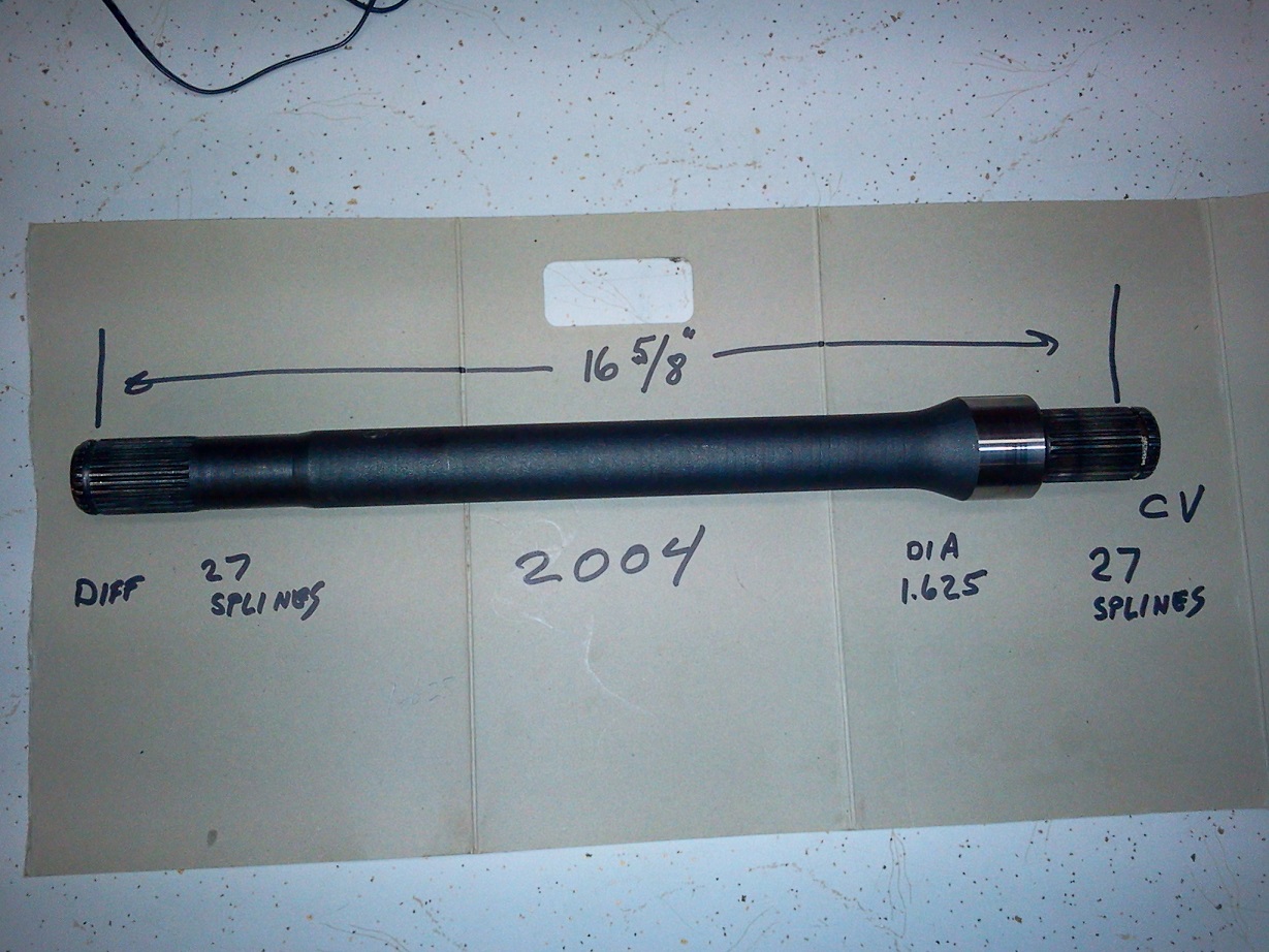

the bearing area on a 2004 shaft mics to 1.625"
looking at the shaft I got from a salvage yard I don't see any reason to go with an new one. there is virtually no wear on this used shaft, that had bearings not bushings.

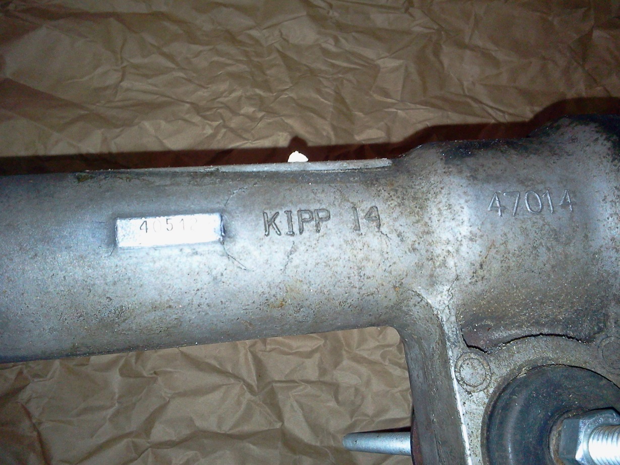

I'll try to get some pics tonight.
that's 40512 on the stamped #
this is a bearing equipped 2004 front axle
over all length, not at notches as it appears due to camera angle.
axle pass side 2004 bearing equipped
