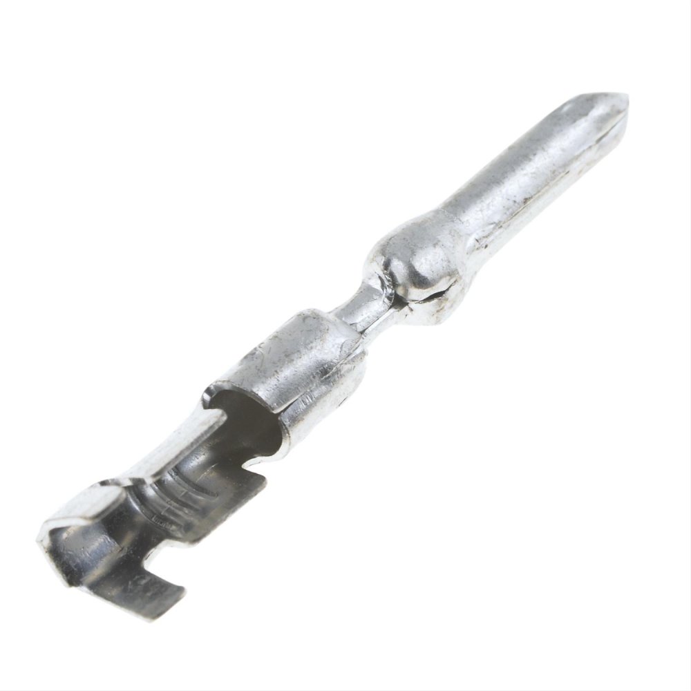

I found these....
Dorman# 85345. No one stocks them. They are available different places online...they 3 bucks for a 5pack...of course 10 to ship the shit.

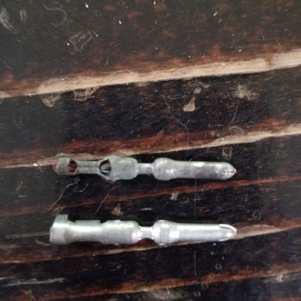

I bought some from napa that seemed close spliced them on and tried it but they wont plug all the way in to the female side and they fit in the plug like garbage
A lot of these terminals will be proprietary, and only the right one will fit the connector body correctly.

This said it was for ford "wedgelock" and replaces ford part number....something. But the number started with E5 or E6 so i figured i was in the neigboorhood.
Rock auto was having a closeout...bought the last 4 boxes (20 connectors) for 9.97 with shipping.
If they said that they're for Ford wedgelock, then you should be OK.

Look like a match to me.
Of course rock auto had 4 boxes left...5 in each package...i got 3 packages with 5 anf one empty box
Yes, that looks like a match.

Hi I realize now I misunderstood your question. You want these;
