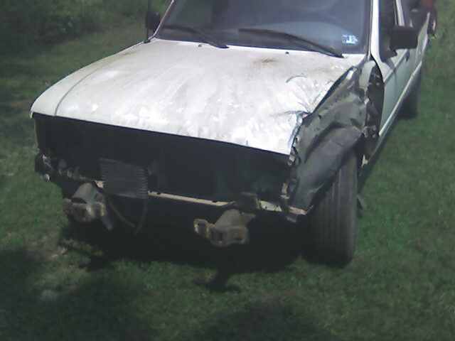

the wreck
the skoal can collection from the truck
the person who formerly owned the truck took good care of the engine, but thats about it.
the box is heavily rusted and the interior is covered in tobacco spit. I am swapping both from the wreck.
