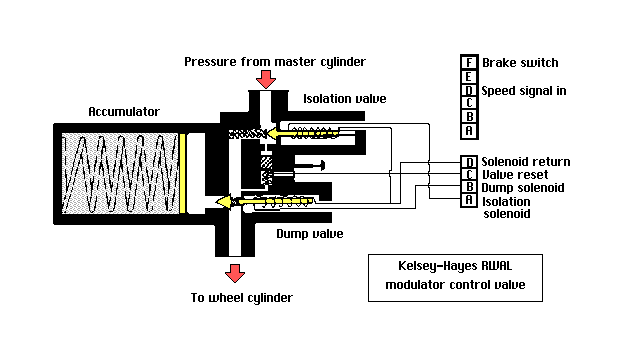

I have heard of people doing that, not only will the rear brakes lock up, but my light in the dash will stay on correct?? Can anyone tell me if the bleeding needs be done repeatedly, or is valve shot??
I know when I did my lines on my 94... in January... I just bypassed the rear abs valve. It was too cold to mess with it. The Brakes work fine and I've noticed no ill effects other then the rear ABS is inoperative.
That being said... If I remember correctly there is a rubber boot on one end and you can push the valve to reset it. Might take some good force to do it and while it is depressed have someone push the brake pedal. You can also rap it with a hammer (valve body) to try and free it up if it is stuck.

It's been written about over and over here and on other forums. 2 search words " bypass RABS
https://www.aa1car.com/library/abs_kelseyhayes_rwal.htm
LOL additionally.. the lines are standard AFTER the RABS valve. 3/16" flare. the line going in is metric..and the rear line from the MC although 3/16" uses a odd size metric connector.. I have more pics of that somewhere. LOL We used a 24" pre-made line and short adapter line.

When a rear brake line breaks... the internals mechanically shift... trip the brake light indicator and attempt to stop the bleeding of brake fluid. It internally needs to be mechanically reset... to allow fluid to flow to the rear brakes. Even the diagram posted appears to have a button for this issue.
Denise I saw you’ve posted that diagram a lot haha. So my light was on and never blinked, was on for about 25 miles before I realized the brake pedal was going to the floor.. then I knew there was a real issue. I don’t mind bypassing as long as the light will go away. Still gotta get it inspected.
I study stuff before getting into it. The light needs to be killed or pulled. some times it goes out with the RABS out. Mine is still on. need to kill for inspection in January on this truck I have now.

Please try Uncle Gump's reset method and then check behind the RABS valve to see if fluid is flowing strong if not the RABS valve is bad and needs to be replaced OR bypassed. I don't know the vehicle inspection laws in Virginia but I have yet to hear of a north east state that says the ABS needs work since it reverts to standard breaking when the ABS system fails. That being said why cant you bypass the RABS valve and remove the light bulb from the dash?
