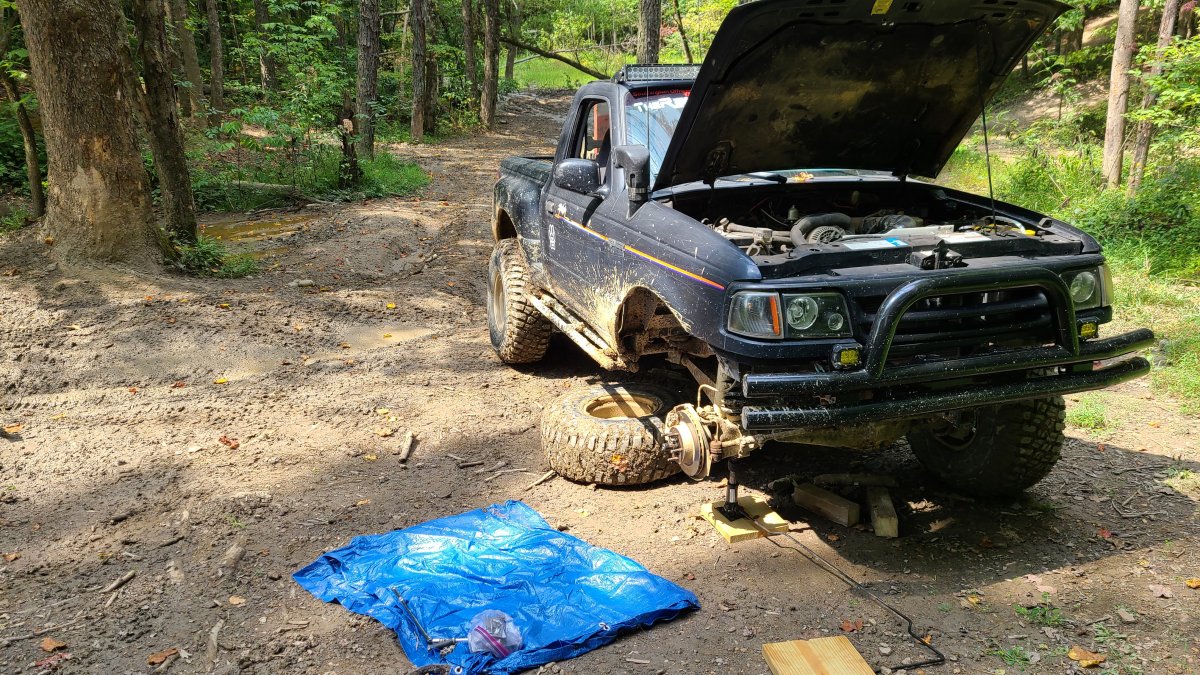

i busted the front hubs when i got stuck a few days ago and about to do the manual hub swap but cant decide on a brand so far ive found 3 options Warn, Mile Marker and Rugged Ridge any suggestions on what to get i know Warn is a good brand but anybody tried the other two brands?

I've broken 2 Milemarker hubs. They were used units I got from the junk yard to replace my auto hubs. I'm now running on used Warn hubs from the junk yard with a spare set ready just in case...
Replacing a broken Milemarker hub "in the field".
