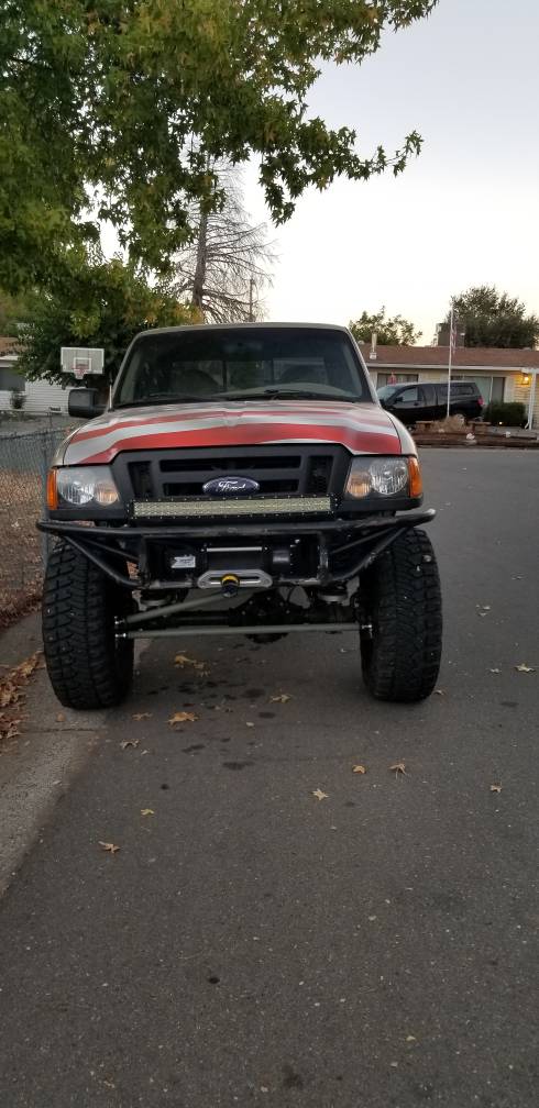

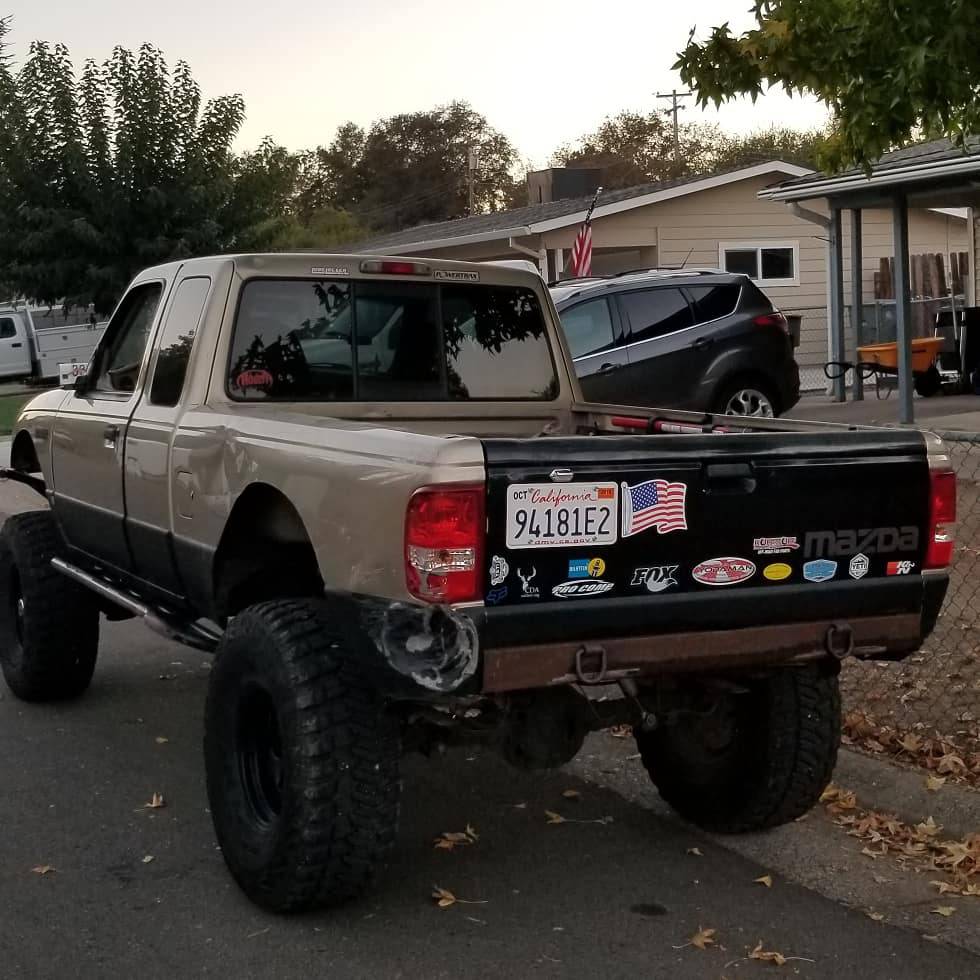

I got it about a week ago, as it sits now it's got about 1000 miles on a rebuilt motor and heads, cut down f150 dana 44 with chromo axles and 4.88 gears aussie locker. Rear is an expo 31 spline disc brake axle with a power trax locker and 5x5.5 axle shafts. It's on 35s and the body is pretty beat. Tub bumper with a winch, has rock lights and light bare that will be rewired as well.
My plan for it is to make a nice driver and camping rig out of it. I just sold my 92 explorer on 1 ton axles, atlas t case and 40s, and I want something that I can cruise around, play on some trails or camp comfortably in.
As it sits now it needs some love on the front end. The heim steering needs to be redone, the track bar heims are worn out, needs wheel bearings, ball joints, and a good scrub down.
I plan on doing some trick storage in the cab and bed to hold camping gear, wire up a nice sound system, and run dual batteries and upgraded alternator, build a rear tire holder on the tube bumper with jerry can rack, install inboard air and tank, clean up some body damage, and use it as much as possible. In the future I may install selectable lockers front and rear as well as a doubler.

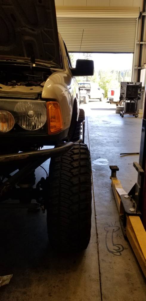

The truck is at my local fab shop right now getting the panhard bar fixed and beefed, plus new heims. Should be done today then I might start throwing all this stuff in the ranger.
Sent from my SM-G955U using Tapatalk
Panhard bar is fixed. Drives down the road so much better now. I think my rear main seal is leaking on the engine so me and a buddy are hopefully pulling the tranny this weekend to put several new seals in and check some stuff out. I'm also hoping to get some of the accessories wired up while I have it apart. Rubicon trip is coming up soon!

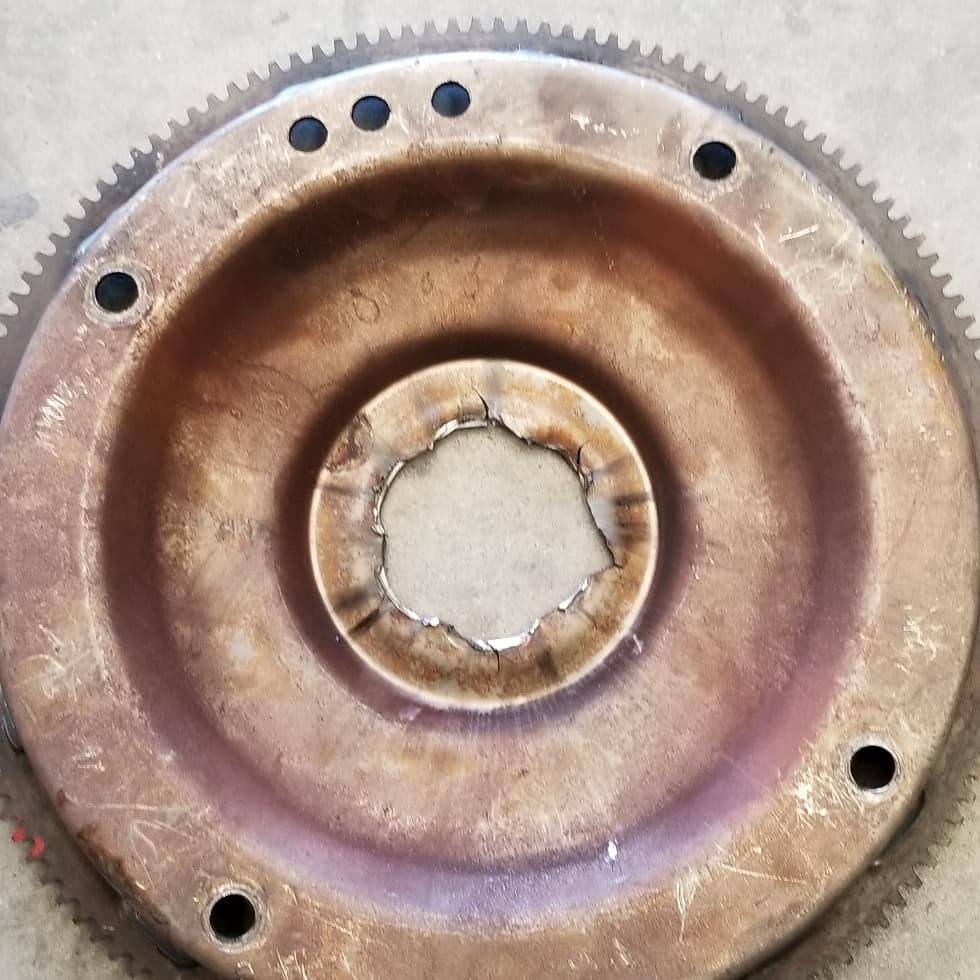

Pulled the tranny to fix a rear main seal and tranny pump seal, found my flex plate literally in 2 pieces. So I am having the tranny upgraded and freshened up. New parts are ordered and hopefully I will have it put back together next weekend. As well as finish installing my pile of new stuff.

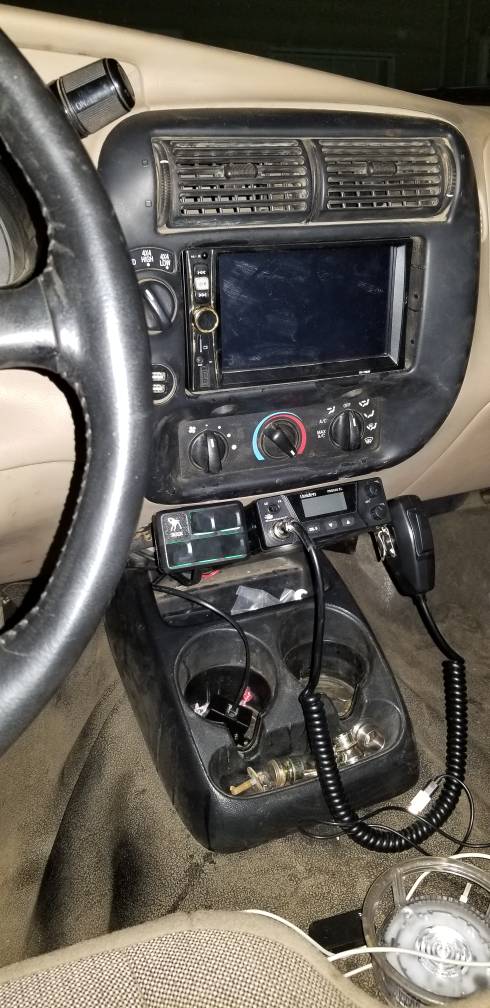

Got my switch panel wired in and threw the switches next to the cb radio. I covered the unused switches in electrical tape, cause the lights without the decals are really bright. Have the panel wired up to a switch that I can turn off and on instead of wiring to the acc. Now i can turn the switch panel on even with the key off.
Rock lights work pretty well. Need 1 or 2 more under the center of the truck and under the bed towards the rear, but its plenty for now and adding a few will be easy later on.
