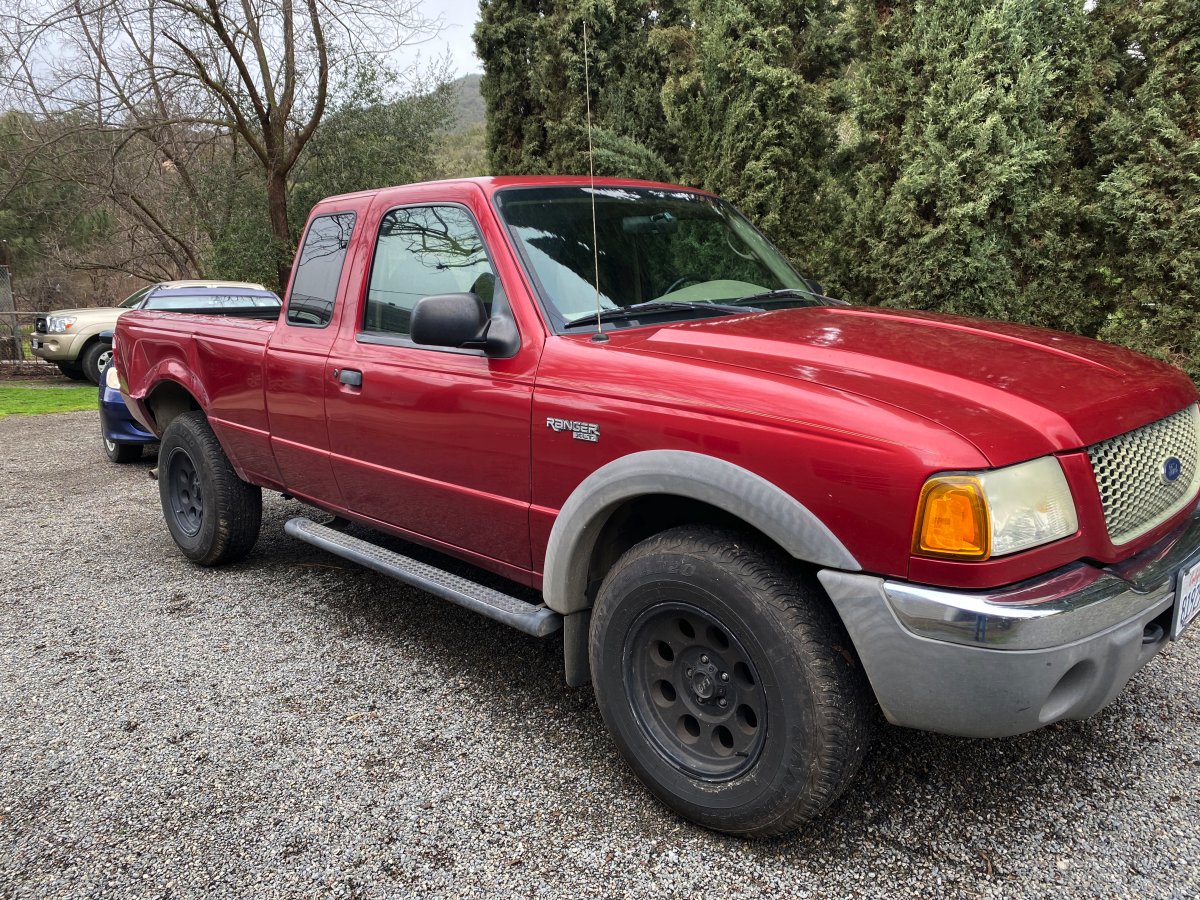

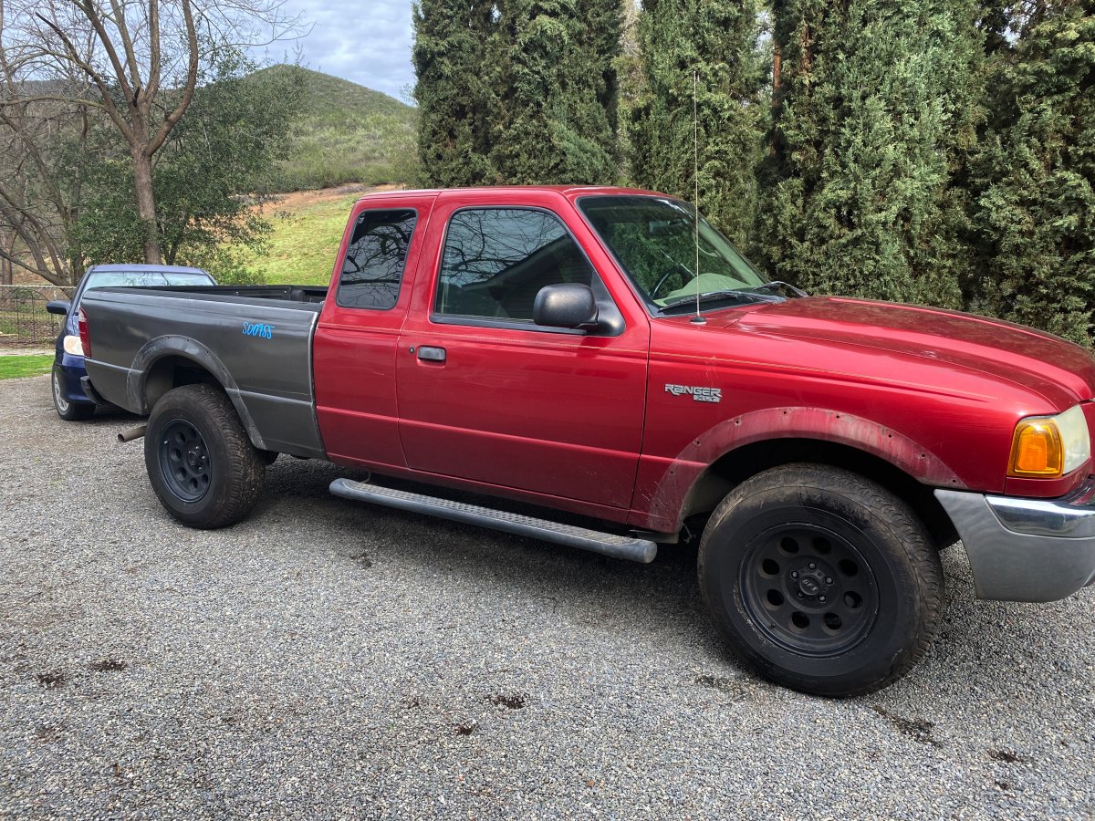

My 2003 4x4 got rear-ended a few weeks ago and insurance company declared it totaled. Truck bed, tailgate and of course bumper destroyed, plus frame got tweaked and one dent at back corner of cab, but still drives straight, pretty low mileage (<140K) and 4.0L running strong. Actually got a great settlement from Geico, about $10K, but instead of getting a new truck gonna fix the ol' Ranger up and pocket the rest of the cash.
New bed is on, pretty much just stripping it down to prep for complete paint job next weekend, taking a chance with a guy that does body/paint work out of his house, he seems very professional so hoping for the best. He's gonna freshen up all the trim and the wheels also with new paint. I'm also going to replace all the emblems, re-upholster the seats, etc.etc.

Hey Gary, actually my Ranger has been rear-ended 3 times in the last 6 months or so. First two times the other drivers were just not paying attention and didn't see me stop in front of them (the first didn't want to report to insurance, and the second guy didn't have insurance). Those 2 times zero damage to my Ranger, but the other cars front ends were pretty messed up. This last time though was on the freeway, the lady behind me was distracted by another driver who was being an ass, and didn't see me slowing down in front of her.
Frame wasn't very bad but my brother-in-law had to straighten the very end where the bumper is attached, with a torch and hammer. The right frame rail is slightly higher now than the left, but I'm just going to put a couple of spacers between the left frame rail and the bed, that should level it out. The new bed I got was off of a 2004, paid $600, I like that it has the spray-on bed liner like my original bed did. $2500 to paint the whole truck, base coat + clear coat, plus paint all the faded trim and repaint the wheels also. There's also a dent he's going to fix on one side.

Hi Kira, yes going to go with the original color. It would cost a lot more to change colors, at least to do it right including door jambs, under hood, engine compartment and all.
