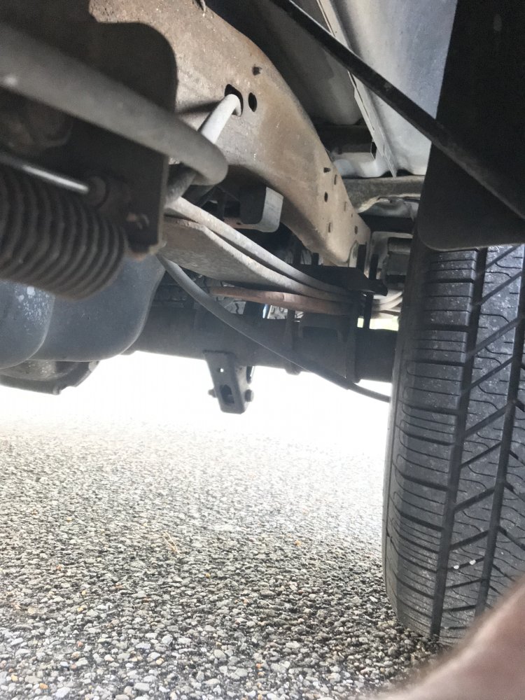

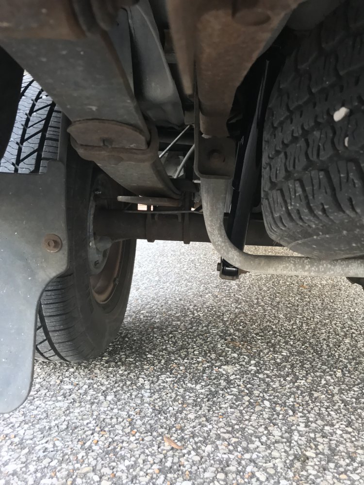

I got an improved feel after changing the front springs and I’m sure the leaf springs are not too healthy. They’re on the list to replace.
How do they look? Three things that look wrong to me are: The front of leaf #2 looks bent, the front tip leaf #3 is almost touching leaf #2, and the center of the assembly looks bent upwards above the axle mount.
Does the truck sit fairly level when unloaded or does it have a rake?
Seems just fine unloaded. When I climb in the bed to get something, it really feels it tho. I’m mean it REALLY feels it. The first time I climbed in it, I kinda froze and got ready to fight not to fall over like standing up in a canoe. Obviously it didn’t flip over, but that’s the feeling I got. I could probably hit max travel of the rear suspension by grabbing the ladder rack and shaking side to side.
The bed should sit high unloaded.
Mine sits about level when unload as the leafs are flattened out from heavy use.
Well by “fine” I do mean level. I guess that’s not fine. Will put in new springs before I get too mad at these cheapo shocks.
You can also consider adding a leaf spring to the pack. It will pick the ride hight up and add stiffness to the spring stack. Although some will say this makes the spring pack too heavy and is uncomfortable to drive when unloaded.
