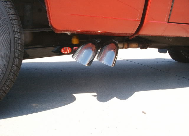

Did you make the bent pipe yourself or did you buy it somewhere? Do you have a sound clip by chance? I was interested in having dual out but behind both rear tires.
A local muffler shop did it for me. At this time I don't have a clip. It's loud. Also, was parked at a friend's machine shop one day, idling. His dad came in and asked me what kind of V-8 was under the hood. It does sound rather aggressive. I wear ear plugs if I'm driving it any distance. LMAO!!

The install wasn’t bad. Be careful, the manifold bolts like to break. Pull the inner wheel wells for room to get straight at everything.
I can’t tell you if there was any power difference, I put my truck down for a week and did the full exhaust, 3.73 gears, MSD DIS-4, throttle body, mass air, etc. I can tell you it made a difference in the sound.
Oh beautiful, well ok i'll keep it in mind. I did hear it's easier to take off the wheels and inner wells, so i will do that. I'll soak the bolts every day with penetration liquid so hopefully that helps. Difference in sound is 80% what i care about haha.
If you're asking me, I bought the mandrel bent Dynomax tailpipe from Summit. Summit also has a Dynomax cat back 2 1/2" system but it's big bucks.
