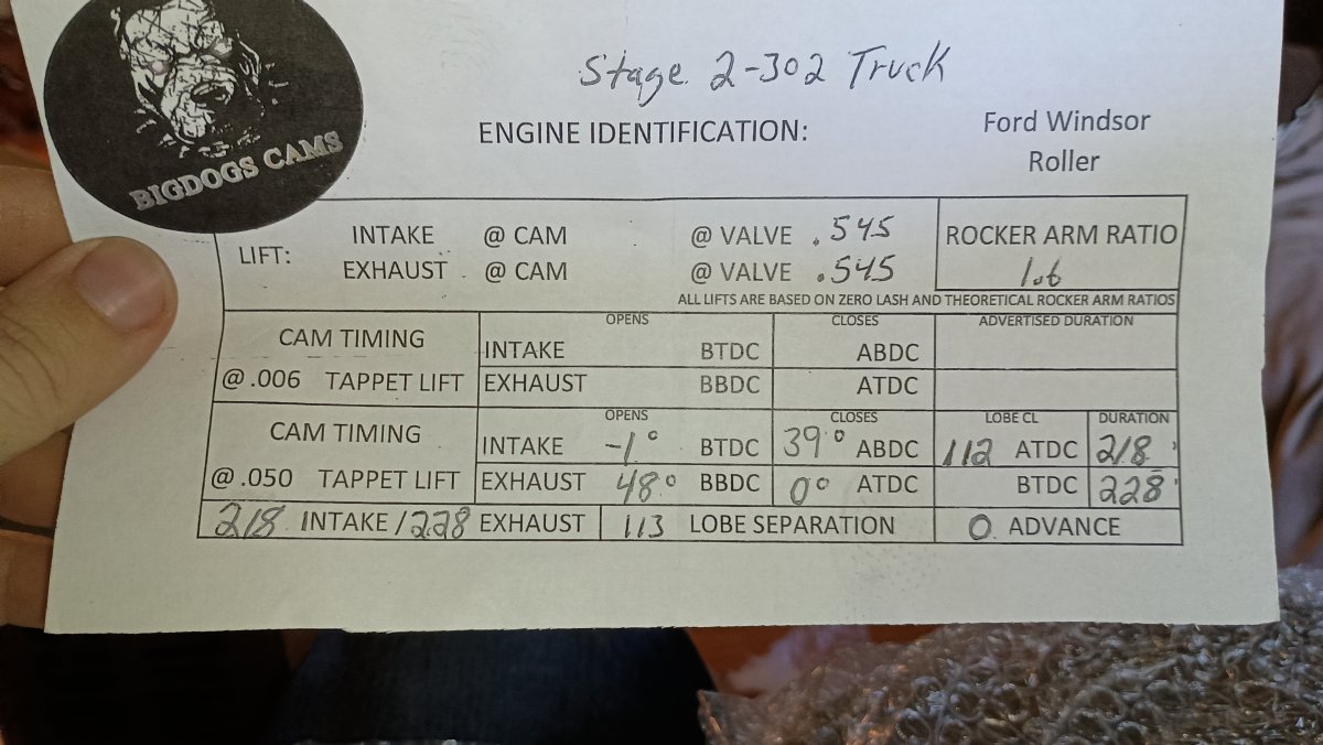

The engine is 2000 Explorer 5.0L. it's getting ported GT-40P heads and a camshaft from Bigdogs Porting through Facebook. I hate to share their "secrets", but cam card is attached for specifications. I have sent this to them as well, but I'm off work tomorrow.and hoping I can go and get pistons and get to shop before the weekend.

Most in stock pistons have a higher compression height, so PTV clearance becomes a concern, but they also appear to have larger valve reliefs. Stock compression height appears to be 1.595 inches on a flat top piston with 4 valve reliefs. The following are what is available in stock at local Summit.

The first would definitely work, but looses some compression, and I doubt I want that. The others I'm unsure about. Price wise I like the sealed power and summit options, and for my build they should be more than adequate strength wise. The KB set is the most expensive at over $500, but it includes rings, which seems like a plus, a is probably the best quality piston on the list. I'm just concerned about PTV clearance. Don't want to get the bottom end assembled and find out that the valve hit the pistons.

Stock replacement/ hypereutectic pistons would be fine and shouldn't break the budget. I would check piston to valve clearance but I'd bet it'll be good. If you use pistons with a lower compression height you'll lose compression and kill power so I'd avoid it.

I also posted in a couple of experienced SBF engine builder groups on Facebook. Sounds like I've got no concerns with PTV on any piston I'd consider using.

I would definitely go with one of the sets that gives you 9.73:1. Your cam is not aggressive enough to worry about valves and pistons meeting.
