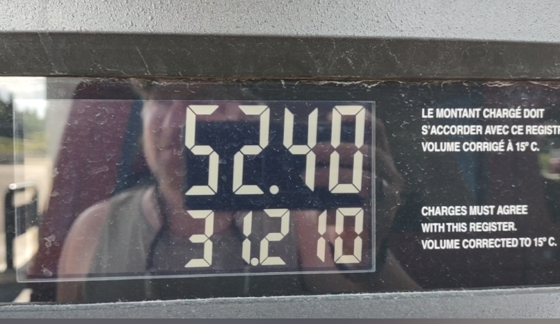

Here's a Bronco update. A few days ago I did a one way trip and it cost me $55. Today I did the return trip, after doing about 30k in town then leaving and did it for just over $50. The price of gas is up, so I think I saved about $10.
What I did was change the tire pressure from 30psi, to 35psi. Not only was the mileage noticeably different, so too was my cruising speed. I did about 10k faster with ease.
Now I'm curious to try 38 or 40psi.

So, to a degree upping your tire pressure can reduce some rolling resistance, but it can reduce your contact patch and burn the middle out of a tire. My F-150 I usually run 40-45 psi because it gets put to work frequently and I don’t have a convenient way to air up right now so it gets run hard all the time and I burn the middle of the tires out. My Choptop on 35’s I run at 10-15 psi because that’s what it takes to get 80-90% of the tread in contact with the road. 35 psi in that and I was wearing about a half to 3/4” wide strip down the middle of the tire on the road with terrible ride quality.
How you check this is draw a line with chalk across your tread and drive a little down the road. I’ll go down and turn around at the neighbors and back and check. Reduce pressure until the tread wears right. You’ll be able to see where the chalk is wore off, that’s what’s in contact with the road. You’ll get the best tire wear and traction out of a wider contact patch.

I get a couple more mpg going to Omaha than I do coming home.
Just the way the hills play out.
Might try it both ways before you get crazy bumping up tires.
I have 31's and a heavier truck and I run 30psi to keep the tires on the road evenly.

I will definitely test it the other way again soon. I'm going to do the chalk test tomorrow
