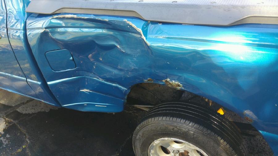

I got gas today and didn't see any leaks, drips, or puddles. No smells either. Where the hose meets the fuel filler neck ports (two ports, two hoses), I saw what looked to be wetness on one hose after I filled up, but when I got home five minutes later, I saw nothing and it looked bone dry.
Can I drill a small hole in the "dent" and pull it out to straighten it even a little? I don't mean straight as in brand new looking, but straight as in flat with bumps. I just want to ease up on that fuel hose.
Get a cheap basket ball and use an inflation needle to let the air out of it. Stick deflated ball between the inner and outer bed walls where the dent is, make sure that you have an air hose and inflation needle hooked to the ball. Inflate the ball until the bed side pops out. This should make it a little better until you find a new bed

Will that be strong enough since beating it even with a hammer doesn't seem to do much? I don't have much clearance to swing a hammer too.

Along with the basketball trick, get a brand new toilet plunger and put a little grease around the edge and place it in the dent where it will make a good seal and you might be able to pull some of it out. That is some pretty heavy damage, but you can try.
In all honesty, if it isn't leaking and you can still fill it up, I would just drive it as is until you get the parts to fix it right

No leaks, just that wetness that I mentioned, which ended up going away by the time I got home.
