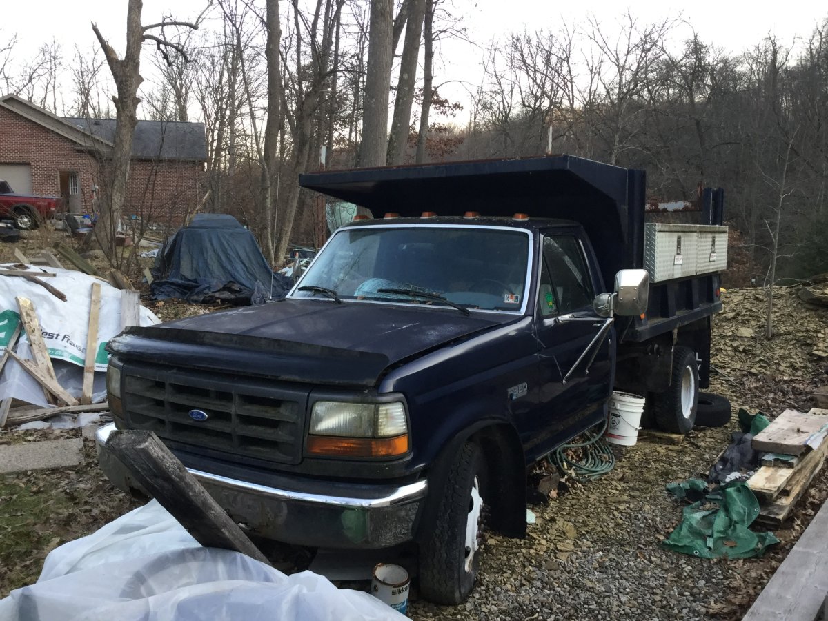

So with winter finally here, this may be a little slow of a build thread to start with, but it should pick up as the weather does so I'll go ahead and get this started.
Dad bought this truck brand new as a Cab & Chassis from Ford. It is a 1994 F-350 XL, 7.5L/460 EFI, ZF5 manual transmission, 2wd dually. Supposedly 4.10 gears and limited slip but I have not verified. Dad has all of the paperwork somewhere including the window sticker and I'll get it off of him at some point.
Since it was a work truck at the time, dad took it and had a dump body built from Imperial truck bodies since he hadn't been really happy with the Thiele dump body that he had put on his 89 F-350. Of course, Imperial ended up not exactly doing what was requested either, so I'm probably going to end up doing something about that during my build.
Dad ran the 94 that he dubbed "Blue" for years as his primary work rig and when I came of age I drove the 89 "Ol Blue" or my 00 Ranger "lil Blue" until towards the end of dad's career when "Blue" developed an oil drinking problem, to the tune of two quarts per tank of gas, or about every 120 miles. At that point it got parked pending repairs and that's where it ended up sitting since dad never ended up doing anything with it. Well, I could really make use of a dump truck, so a few years ago I handed dad the cash for it. Had a bunch of other things to deal with so once I discovered that the problem was the valve guides, it took awhile to get back to the project. That time has arrived though, since my Ranger and Choptop are both on the road currently and my F-150 is essentially walking wounded at this point. I really need the dump truck for continuing work on my property and I need to have a full-size truck around. To rebuild my F-150 is on the plans, but it's going to be a far more extensive project than fixing the dump truck hopefully will be. Anyway, on with it...
Current Specs:
1994 F-350 Cab & Chassis with dump body
7.5L/460 CI motor
ZF5 manual 5-speed
Current Plans:
Pull heads, have a local machine shop refurb them
New cam, RV or better
Probably roller rockers
Headers - ideally
e-fan - likely
Extended Radius arms - likely
Custom front winch bumper
Bed repairs
I'm not trying to make this thing some sleeper monster powerhouse really, but it needs some help. The 89 dad had was a nearly identical truck, all the same options just different years. The 89 would run circles around the 94 and had a lumpy idle. Dad knew someone at Ford way back when and they confirmed that in 89 Ford used RV cams in a lot of the 460 motors. If I'm doing a better cam, then I might as well give it a little love all the way around. That said, I'm open to suggestions on this project.
