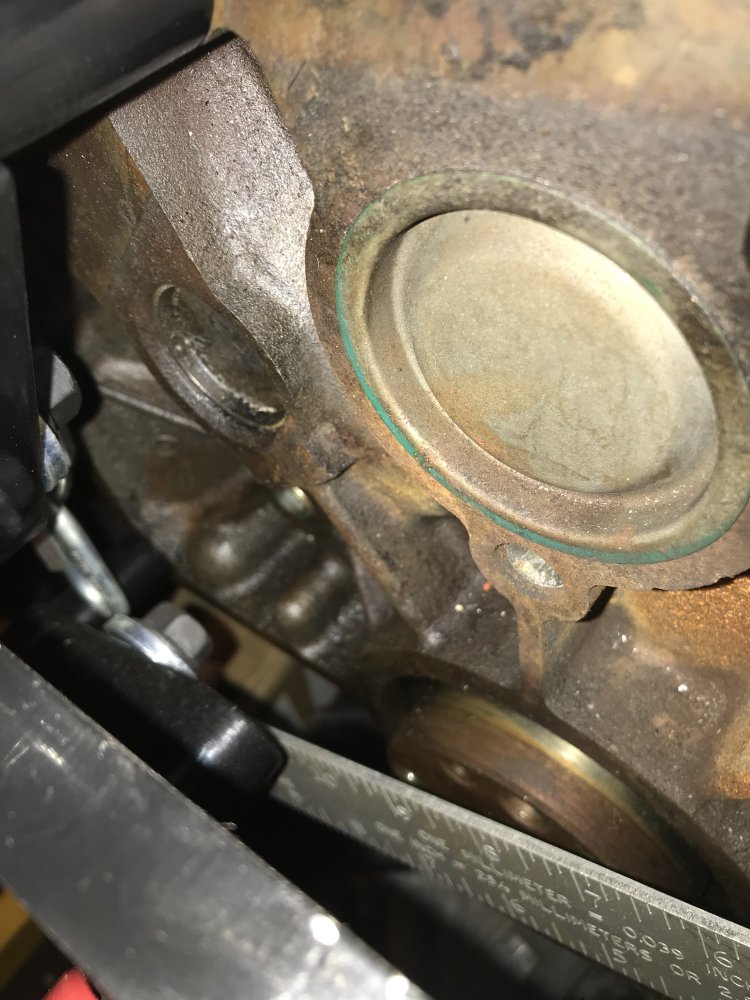

Hey all I’m new to the forum, I have a 2000 ford ranger 3.0L V6. My headgaskets are bad, and I’m planning to do them myself. Done all the research and it seems pretty straight forward. Gonna have a buddy of mine who’s done his help me too. But the question I have is… on each side of the block there are freeze plugs. The driver side has one next to the oil filter with a hex head (I think might have my left and right switched) screw under the freeze plug, then on the passenger side there’s another freeze plug behind the motor mount which has a square head (again might have em backwards) screw. Are they both coolant block drain screws? Or is one for oil and the other for coolant. The reason I ask is because I have alotttttttt of rust and gunk and want to do a very thorough flush and want to drain the block. If anyone can tell me if those are coolant drain screws or not that would be much appreciated.

yes those are water jacket plugs. they are usually stuck in there real good. heat, swearing, & bleeding work best for removal.

yes those are water jacket plugs...

They are?? Awesome, wasn’t sure if both on each side were because I read that some bolts under the freeze plug are actually holding the freeze plug? I’m clueless on that part, I know basic mechanics (I.e. tune ups and water pumps and sorts). I plan to flush the block with thermocure to remove the majority or as much rust and gunk as I can before tearing the heads down.

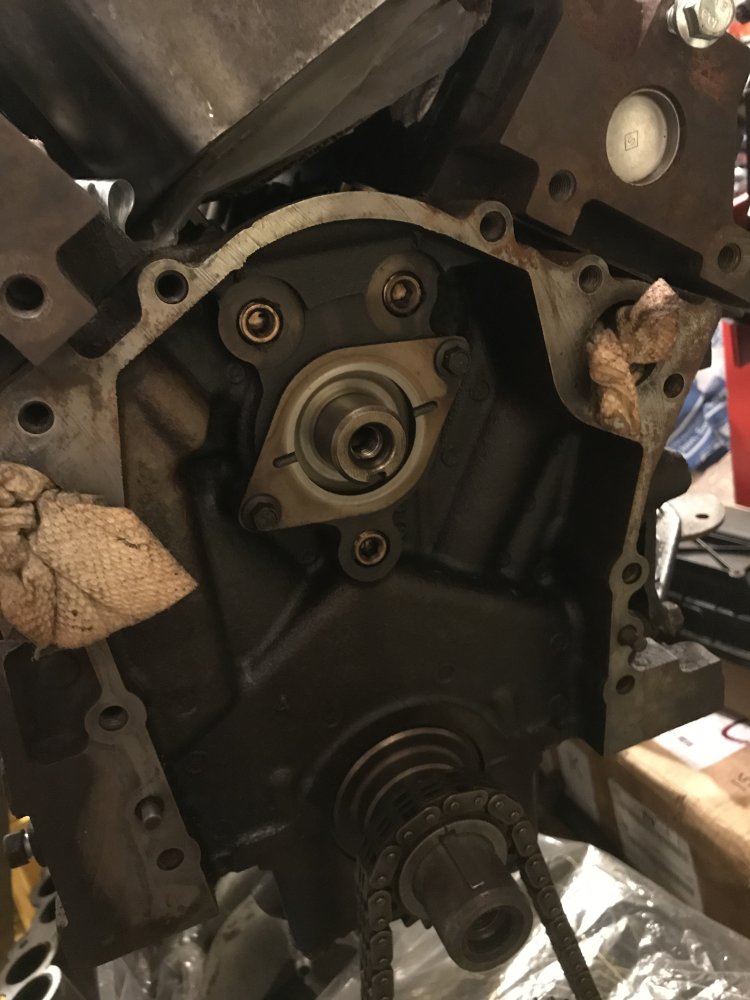

3 in the front, that's the camshaft in the middle.
only 1 I could see in the rear. that is not a freeze plug. it's the camshaft don't-go-out-the-back plug.
