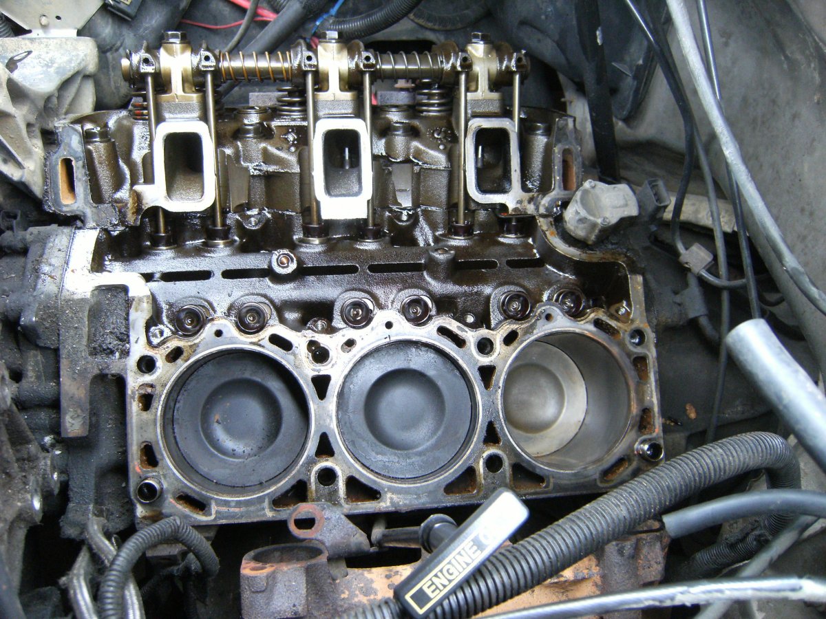

This takes off from upper intake removal. As I didn't take any pics before this section. I have the driver head off this is how I left it last night.
The clean piston top is the blown head gasket.
So after the head is removed a look over the gasket shows the problems.

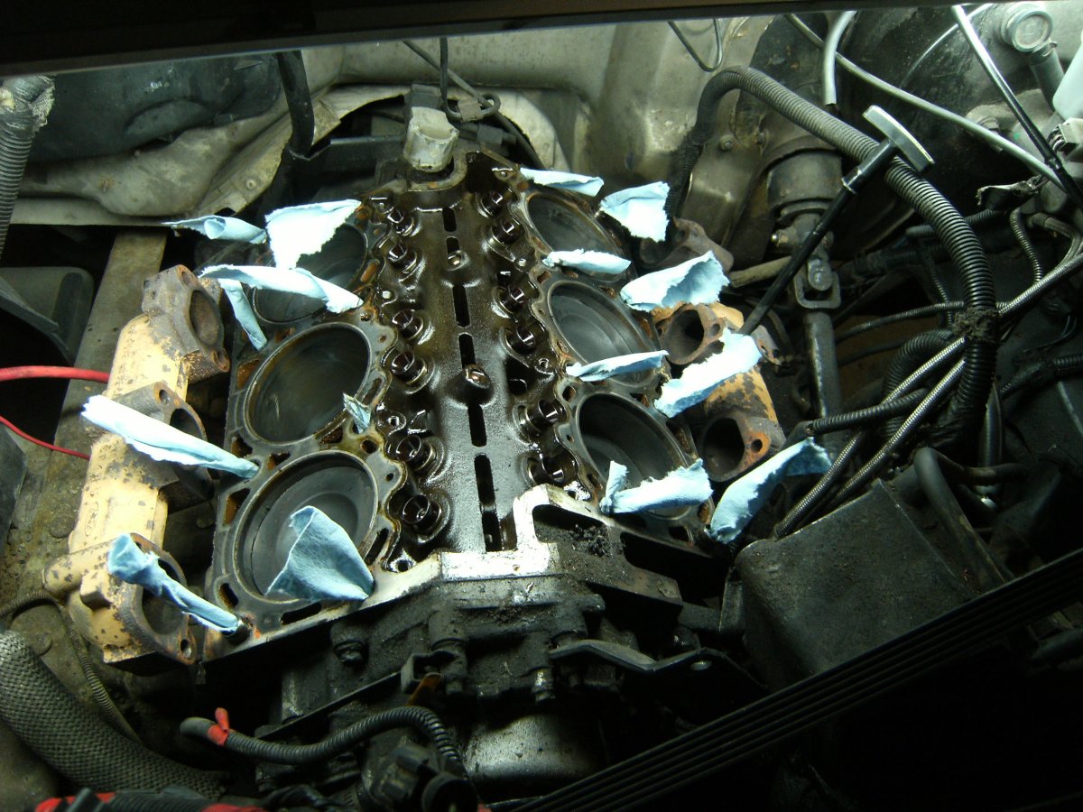

After the heads are off, I recommend rolling shop towel into strips and placing it into the head bolt holes, and also the intake for the rail's holes. This cleans out any oil and water that could be trapped in there. When returning the head bolts into the block this will prevent a oil locking in the hole and gives a true fit/tightening. after you use the towels, I also finish the cleaning with cotton swabs (Q-Tips) to make sure these passages are free of any liquids.

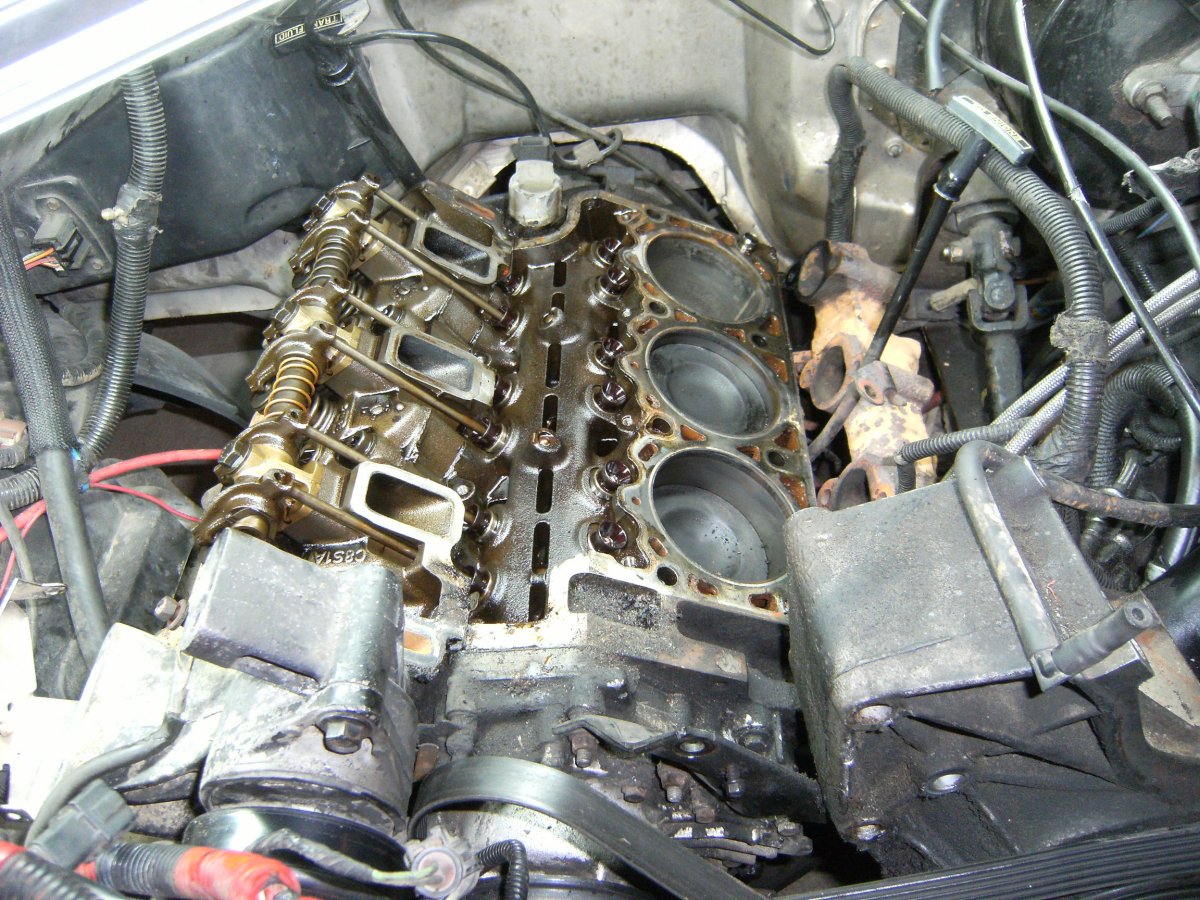

When removing the heads, the rails will need to be taken off. I keep track of what push rod goes with what rocker and keep them all laid down in the same order, when replacing them they should go to the same ones that they came off of.

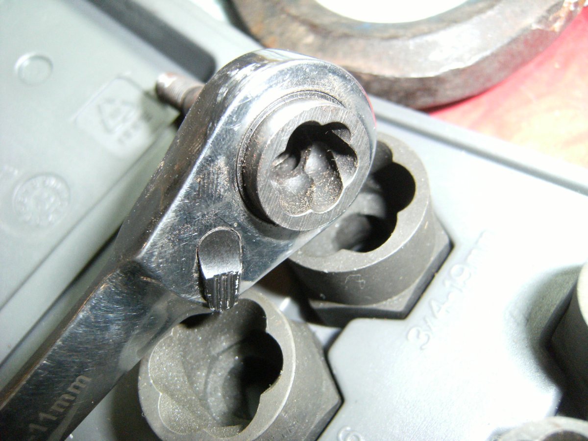

I do recommend getting a set of these reversing wrenches and or a set of reversing sockets. The exhaust bolts can be very tough to remove from the heads. If they slightly start to strip they can easily round out. Another option is to try and crack them loose while engine is still hot. If they start to round out, stop turning and go to the reversing tools. Nothing hurts more than rounded exhaust bolts. As you can see I had to use one for a rounded bolt.

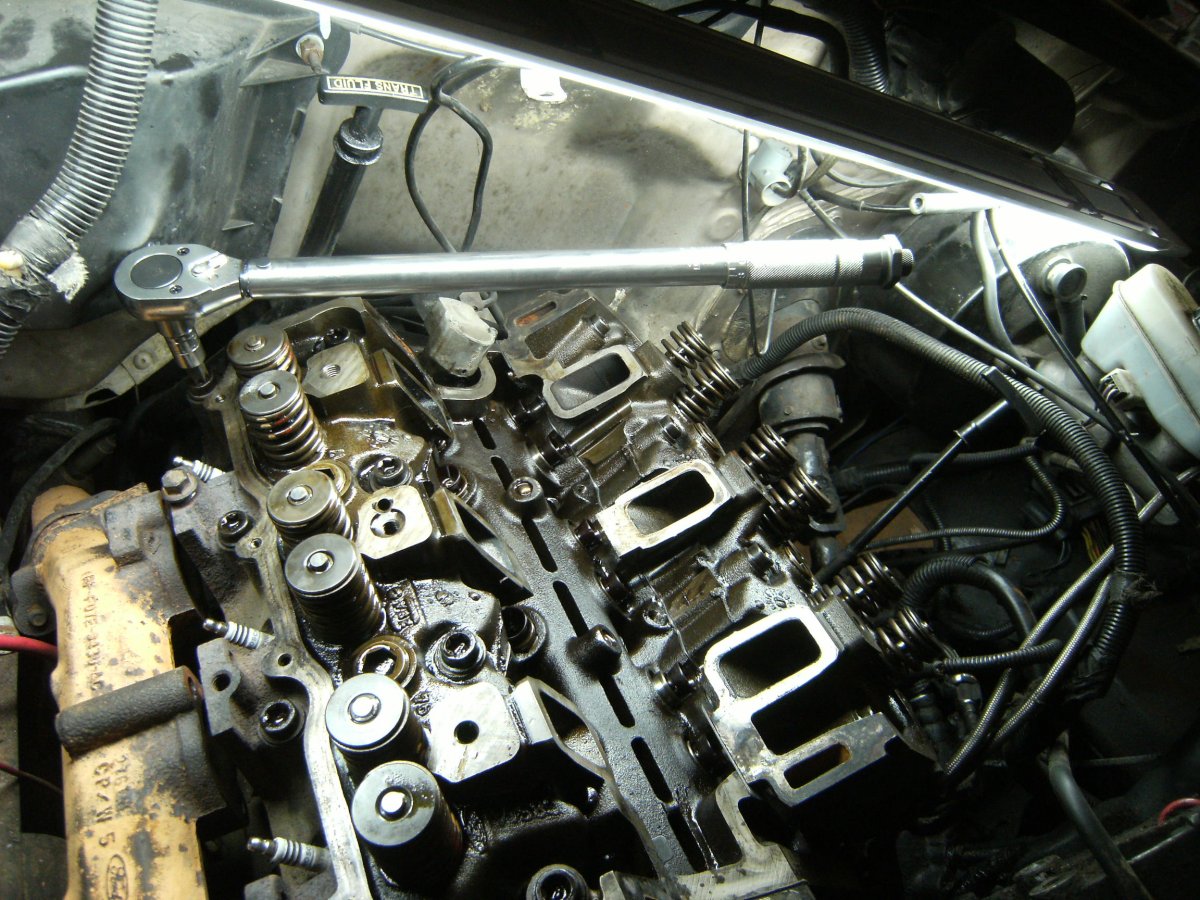

You will need torque wrenches to properly put the bolts to the desired pressures. There is a process to installing the heads.
when the heads are on the block, follow the sequence for the bolt pattern. (Felpro gaskets have a cue sheet to follow.) Do both heads to the first stage (44 PSI) then place the folding intake gasket over the valley. This can be a bit intimidating as it will not fold and sit perfect at first.
In the kit could be a tube of gasket silicone. apply to back and front of the block where the intake will sit. (read the sheet included in the kit) it is your friend.
With a small torque wrench apply the desired pressure. the folding gasket will start to bend into place. take care to feel the bend and align if needed. the heads and the intake get tightened as a complete set, so you need to go back to head bolts for stage 2, then back to the intake again.

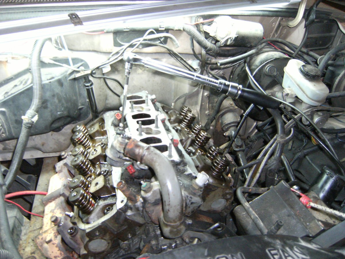

The type of head bolts are a size 55 Torx. No way around this, get the proper tools for the job. Mine are 3/8 drive, Would prefer 1/2 inch drive as they take a good deal to loosen and place on. The 3/8 also gets a 1/2 inch adapter to fit the 1/2 torque wrench. Weakest spot is the adapter. (maybe I ask santa for a 1/2 drive set
) A breaker bar 1/2inch also gets the extension (floor jack handle) stuffed in for more leverage to remove the bolts. #6 cylinder can be a pain to get off, as the heater box could get in the way of a good bite on the top of the wrench. take cation on that bolt to not slip it. (passenger side back bolt) (see pic)
