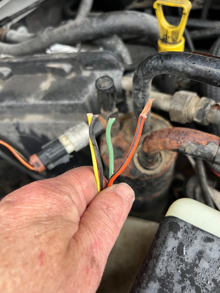

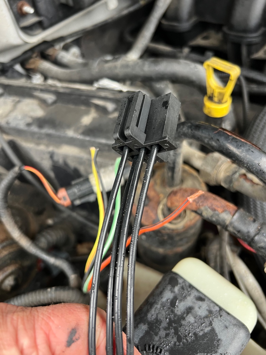

Ok…super embarrassing…I am replacing the resister and the connection was rusty, new one came with a new pigtail so using that…but….i have no idea where the old connection went so do not know what wire goes where on the new pigtail..🤦🏼‍♂️
Can someone share a pic before I spend a lot of time with a multimeter? Thanks…

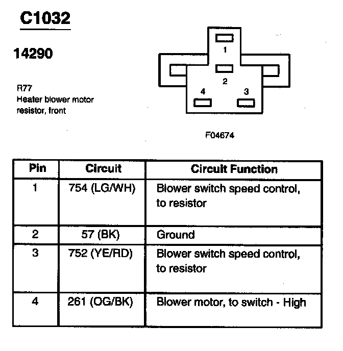

Awesome and thanks! where do you find that?
I need to get a FSM…
Electrical diagrams book. For older models, it is called the EVTM. It's good to have one for your exact vehicle. Usually available on ebay. One of the most valuable tools you can buy.
