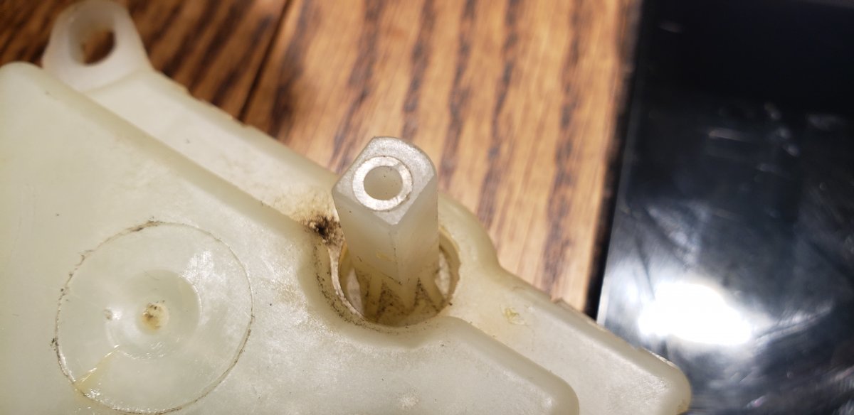

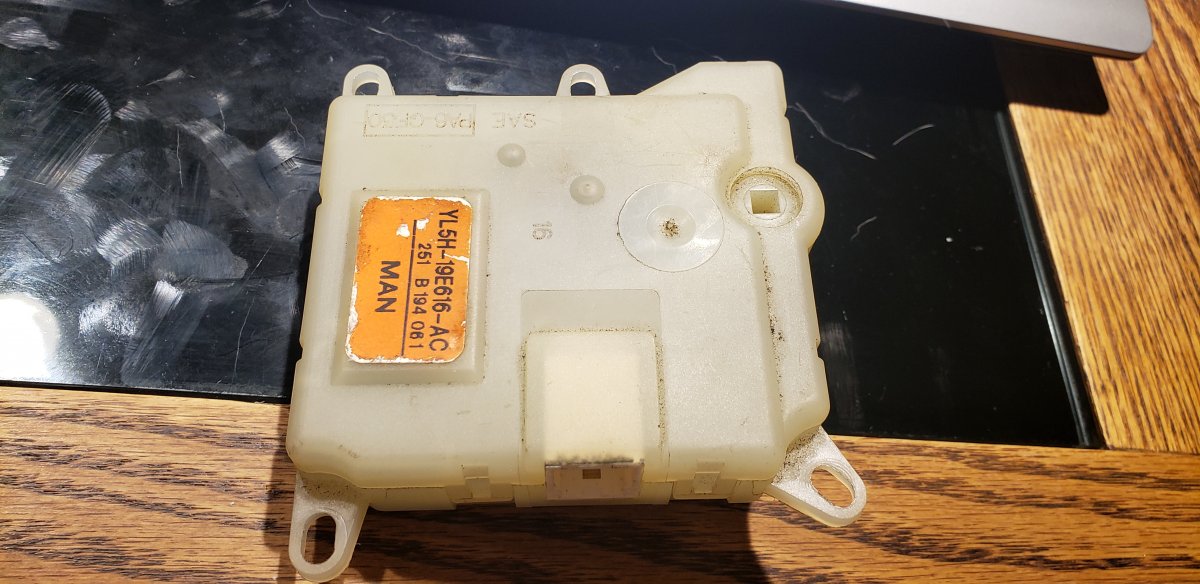

The part number that in stock at my local advanced auto store is a "Dorman" number.....604-203". This is what they had. Using the number"YL5H-19E616-AC" This replacement motor assembly comes with a longer drive tang. So do this.....and take pictures for reference, and not of your skinned hands.

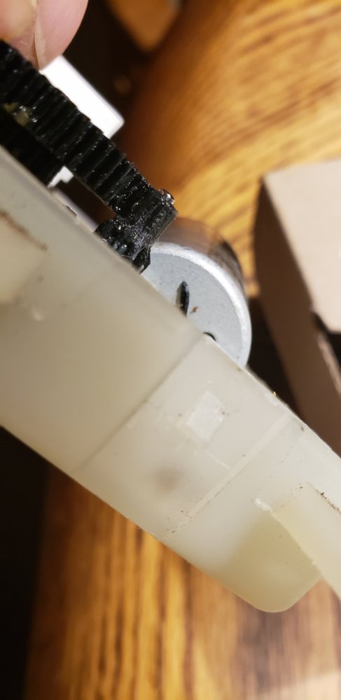

7) Using a shortened socket & a 1/4" ratchet works to remove that rear fastener. And don't drop that damned ratchet inside like I did. You may want to have second ratchet & socket nearby. Pull out the old controller. Plug it in, start the truck, see if you can move the shaft while inputting different temperature settings. If it works, I take it apart, clean & re-grease. You then likely have a broken dampener door. Look for pieces on the shaft.
You may want to take the controller apart & verify that a part has failed inside to find additional motivation to drive to the auto store & back. Or send the old lady and get some tacos.

2) Notice that the part has an extended drive tang (with gussets)
3) Find a old shoe box or some combination of 90 degree surface angles to represent the exact new & old drive tang modifications. And then hack it off in a vice.
4) Next step is very important, it won't engage into the blender door yet. Aquire some sort of dremil & sanding drum. Sand off the gussets down to almost the enclosure. Look at what has to be done carefully as you are contouring something by eye because it could be a big difference in system performance.

5) Install the new controller with the connection out front and while turning the temperature selector using very light force, let the new controller engage the drive tang into the dampener door. Remember the gussets molded into the lowest section right up to the housing on 3 separate sides right? And you sanded these down real well right? Don't know if the center needs cleaning out but I did anyway. Once the shaft was finish sanded (w/dremil).
